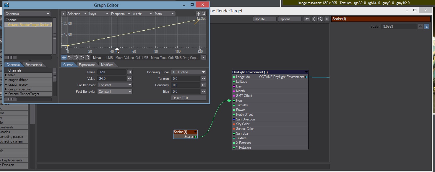

I tried plugging in a scalar node to the suns hour input but it does nothing. I then tried setting it to direction and pluging in a vector, still nothing. I must be missing something but I can't think of what. Is it possible to animate the environment?
juanjgon
Posts: 8867
Location: Spain
I am testing this feature here and all works fine. Can you share a sample scene with this problem?

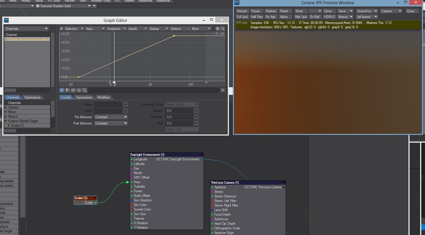

It happened again. It seems to happen only after I apply animation to other lights in the scene.
juanjgon
Posts: 8867
Location: Spain
Weird, here it works, but I don't have the scene objects. Do you have this problem only in the IPR while you move the time line, or you get the same problem with F9/F10 rendering?

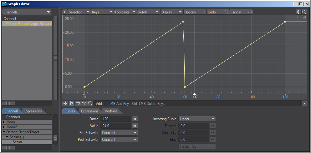

mikefrisk
Posts: 172
Joined: Fri Aug 29, 2014 9:17 pm
It seems to have trouble going past 24 hours so I had it reset to 0 after 24 and go back up.
This seems to have fixed it for now.
juanjgon
Posts: 8867
Location: Spain
Ahhh, yes this could be the problem. This parameter should be always between 0.0 and 24.0.

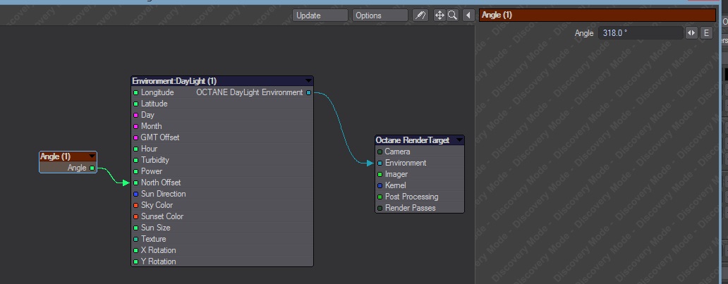

juanjgon
Posts: 8867
Location: Spain
If you are not aware about the parameters limits, you can check this parameter in the Standalone. For example the north offset in standalone works from -1.0 to 1.0, but in the LW plugin it is mapped to degrees, so it should work from -360º to 360º
If you want to animate this parameter, you can link a constant angle node to the north offset input. The range for the animated parameter should be again from -360º to 360º
