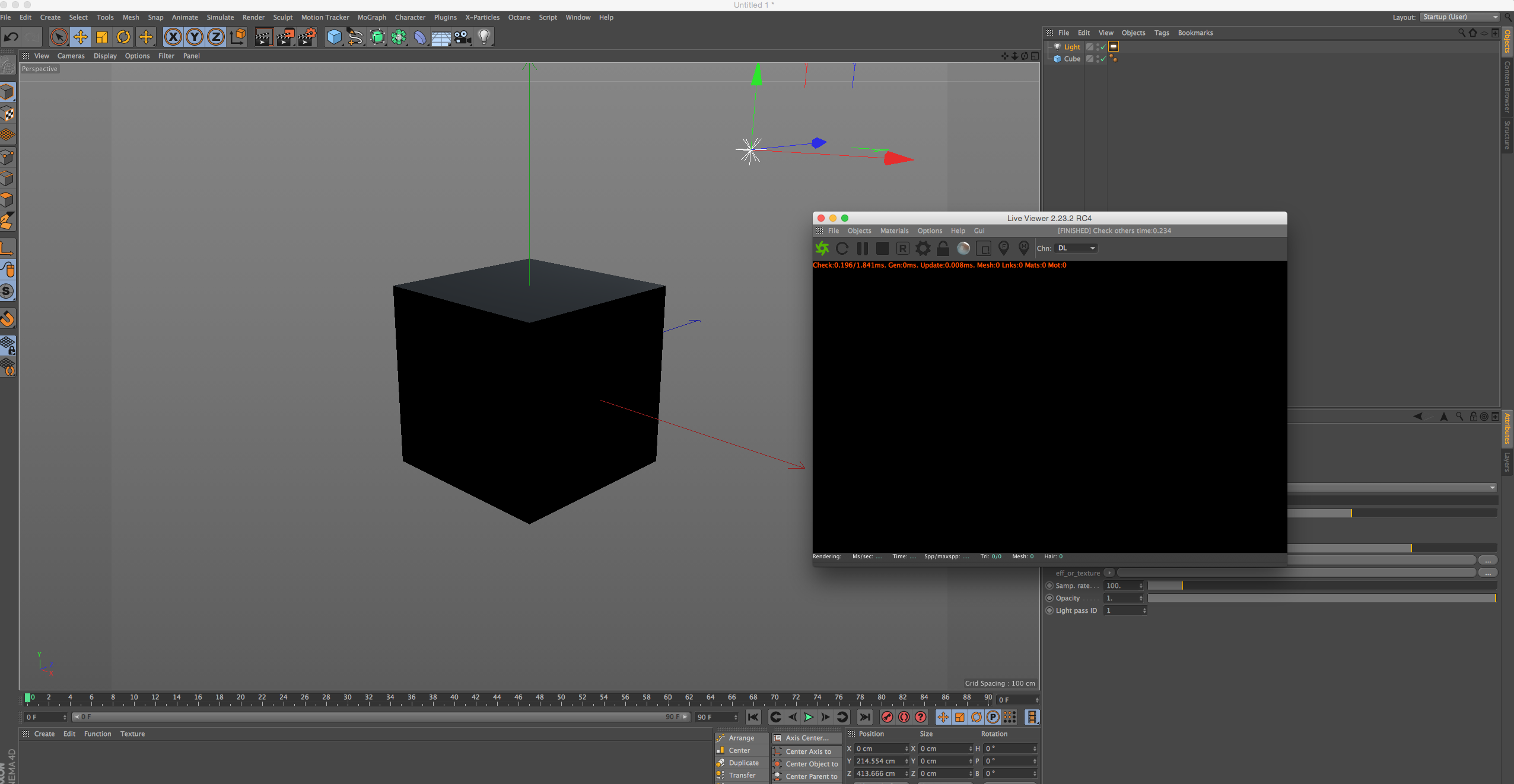

Im having the same issues on R16. I have the latest nvidia, tried light, tried environment trick still black. IMG attached
PLEASE HELP!
