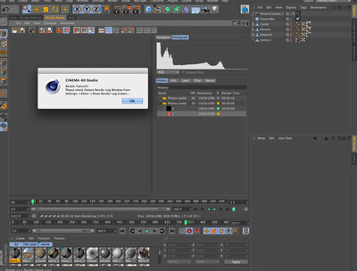

Has anyone experienced textures that do this? Sometimes the textures go to black and some frames are rendered as pink noise. Have a couple of project files that i'm experiencing this with.

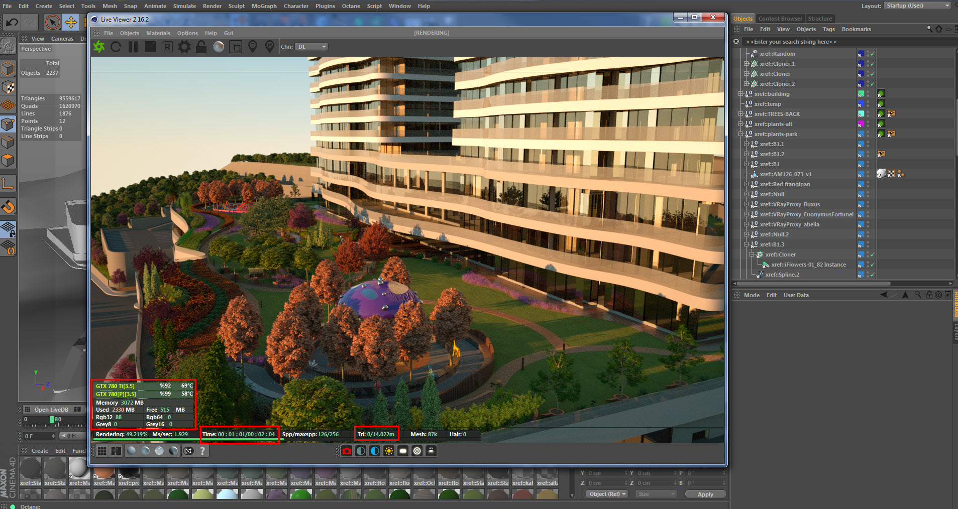

Macosx users have similar problems. Because some of them have only one gpu with low vram, even OS consumes lot of vram.

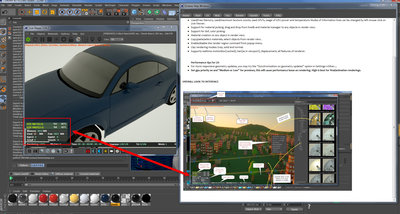

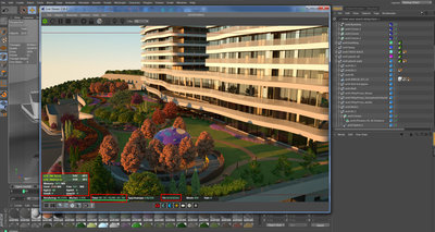

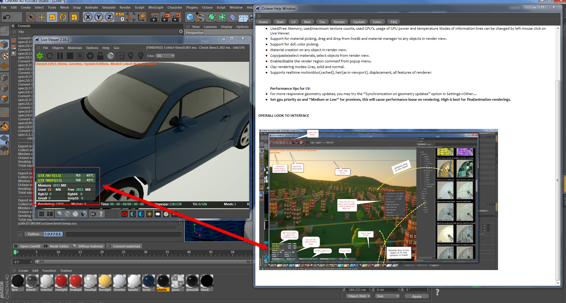

Ex. macos can takes about 1gb or much ram, Octane only can use little ram. Check my images, i have 6gb 780 + 3gb 780ti together.
See how much big scene, lot of objects can fit to gpu. But you should carrefully optimise your scenes. See also marked areas. Don't go forward without understand that how is working the Octane and what's the limits and tricks. If you understand well, you'll be happier.
Without forget, please use a newer version. I advice the 2.16.x

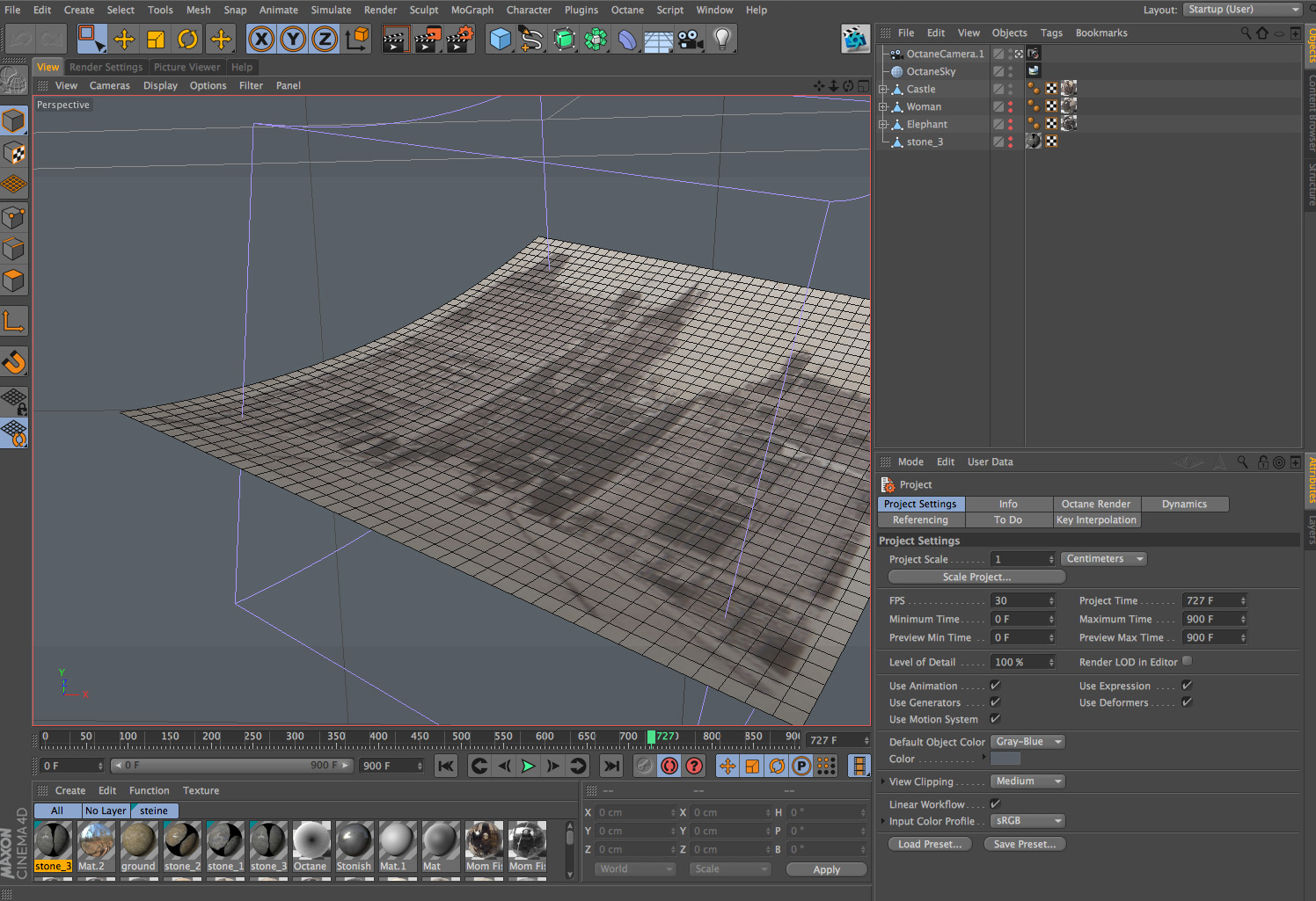

RouseandFable
Posts: 72
Joined: Sun Dec 21, 2014 9:09 pm

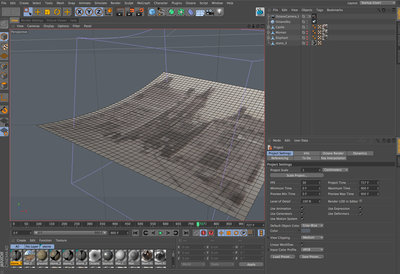

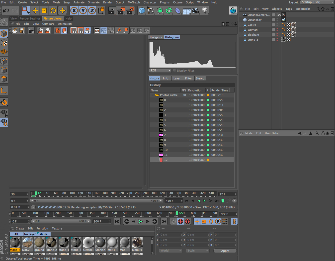

Aoktar, thought i would show you how simple my scene is. I have a plane with a photo mapped onto it. I've turned off my other layers. I had other photos and a background image before. If you look at my render history you'll see missing frames and ones with nothing but noise.
Posts: 16066
Location: Türkiye
Please fill your sign with version and hardware specs, you don't help to me for saving the time. Your scene may be simple but have several images. All is in vram of gpu. And it's clear that you have vram problems while rendering. What's your free vram, gpu model? version?
Use last version from link, also watch the videos and read the manual in links.
http://render.otoy.com/forum/viewtopic.php?f=30&t=44177
