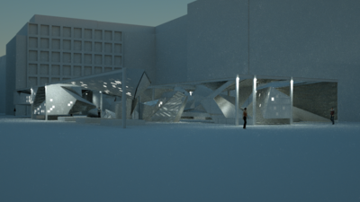

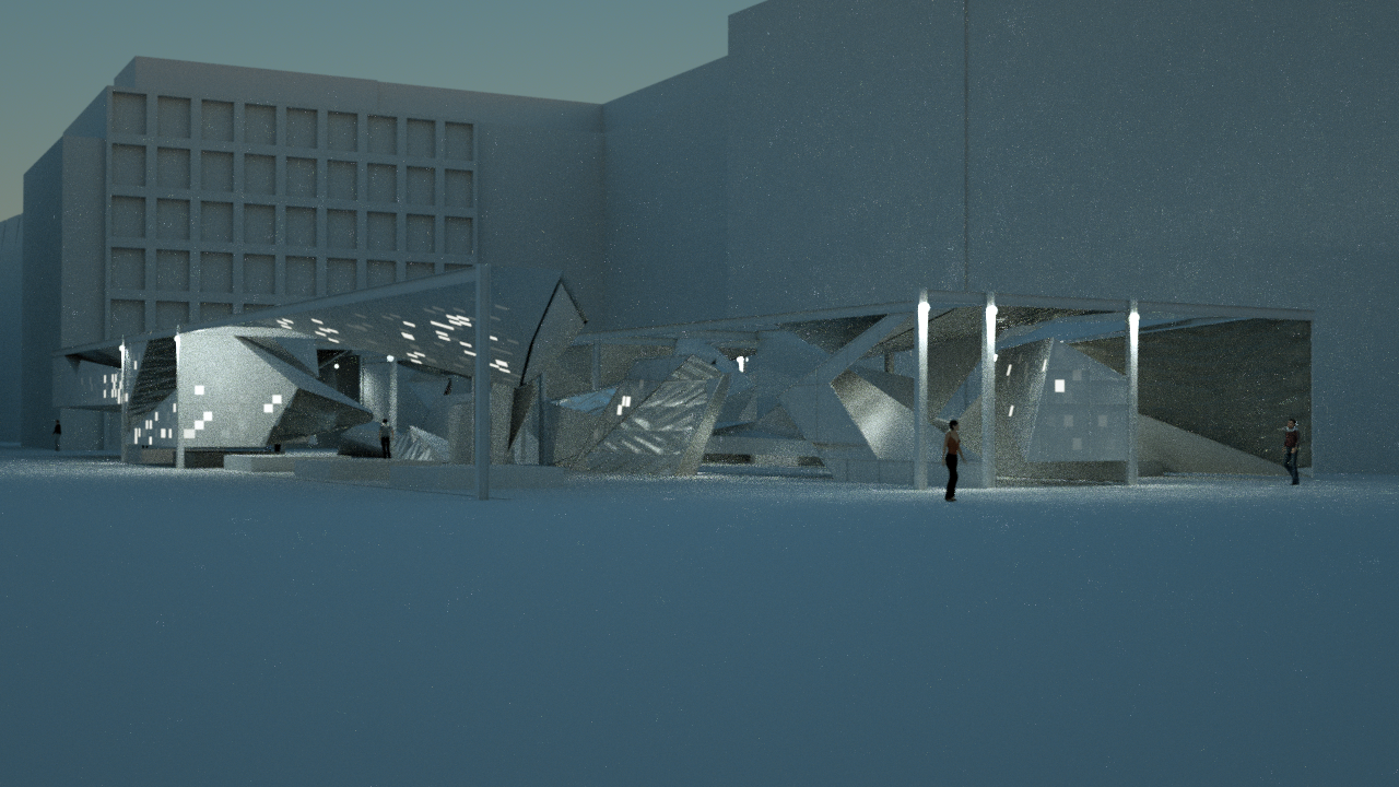

So I figured out that one way to animate light with octane render is to use diffusive shader with texture emission and autokey frame the power parameter.
I worked on this scene with there different light textures and as you can see the three different textures that are keyframed differently over time. https://www.youtube.com/watch?v=7PZ9wbsTXJE
I think there must be a better and more expressive way to control light intensity parameter then creating a new texture for every light that behaves a little differently. For me the problem is that I am quite new to both 3ds max and octane - both less then 6 months exposure.
To do what I did in the scene, I actually modelled the basic geometry with rhino-grasshopper and detailed the surfaces into little squares using revit 2015.
I would like to know how one might achieve an effect like a geometry moving around the scene and the light intensity changes depending on how close the center of the geometry is to the moving object. If I were to create a new texture for each square for an effect like this, it would literally take hundreds of textures and days of keyframing. I am looking into the shaderFX and phython solution but I actually have no clue.
