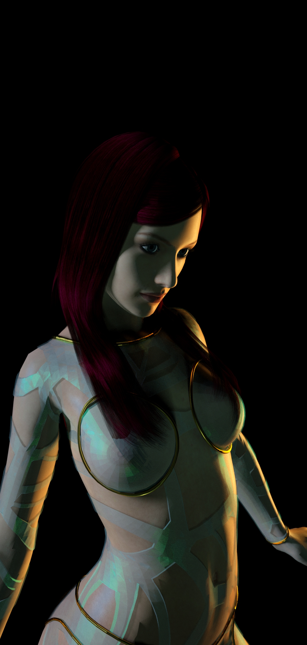

Here is an example using 3-point light setup. THe lights are thin cylinders 60cm diameter x 2.5m height
Sample three point light 1500 samples

Thank you kraken, recently I've found that solution. Somewhere I read that it was indispensable to use ies light but I tried with a simple plane and it worked. Very interesting your render, I like very much the lights' effects. Bye
