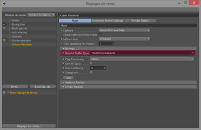

Here in pink: Float(tonemapped) or Float Buffer
Render Buffer Type
Render Buffer Type

Thanks! Know where I can find some documentation on this setting? I have read about it before but can't seem to find it. Not sure why.

Can you provide a brief breakdown of scenarios that would benefit from each of the 3 buffer settings? I was using the 8 bit buffer when I was getting banding, just now tried Float (tonemapped) and it rectified the issue! Thank you for that.

First option is 8bit buffer. It's same as in Live Viewer. Because live viewer uses also 8bit buffer due performance. I think this is very clear.
Second is float(tonemapped). It has 32bit pixel depth for each color channel as you know. Also reflects the tone mapping of camera imager. And output values are limited between 0-1. values than bigger 1.0, will be clamped to 1.0.
Last is float buffer. This is raw colors of renderer. Colors will not be clamped in this mode. So you can have values which are bigger than 1.0. Also gamma is 1.0 for colors. Even there is no any camera imager effect. Best saving options for float buffer are 32bit tiff, exr or psd.
On you render, that was the problem. 8 bit depth is not enough to fill the semitones of close colors. I hope all is clear. Don't forget that practice is your friend.

Thanks for the information. Sounds like tonemapped is the way to go. I think I used to do that and just forgot to check that setting. It seems like tonemapped would be a better default setting than 8 bit.
