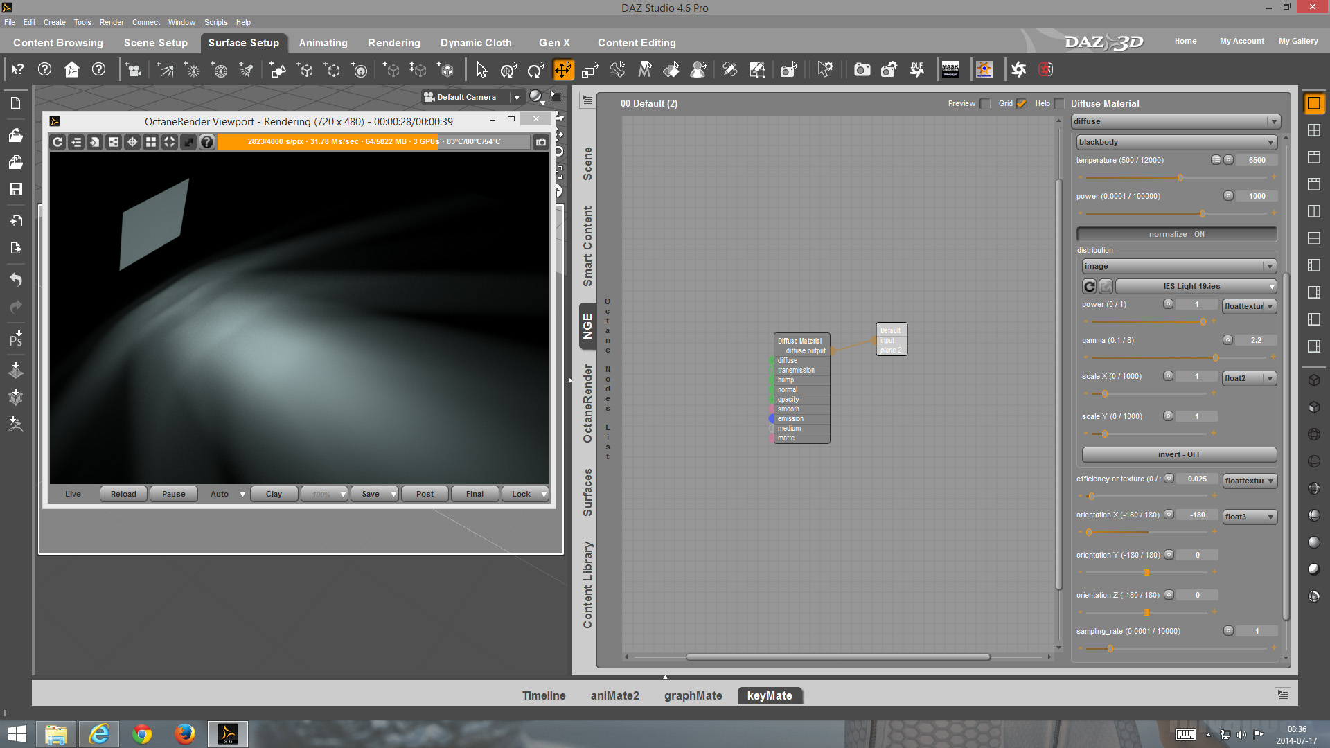

Was there a change in how IES lights behave in 2.1
Before i was able to rotate them in studio (create a light disk) and the IES light would change direction based on rotating the prop in studio. Now it make no difference, what i do in studio. the light always seem to point strait down.

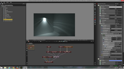

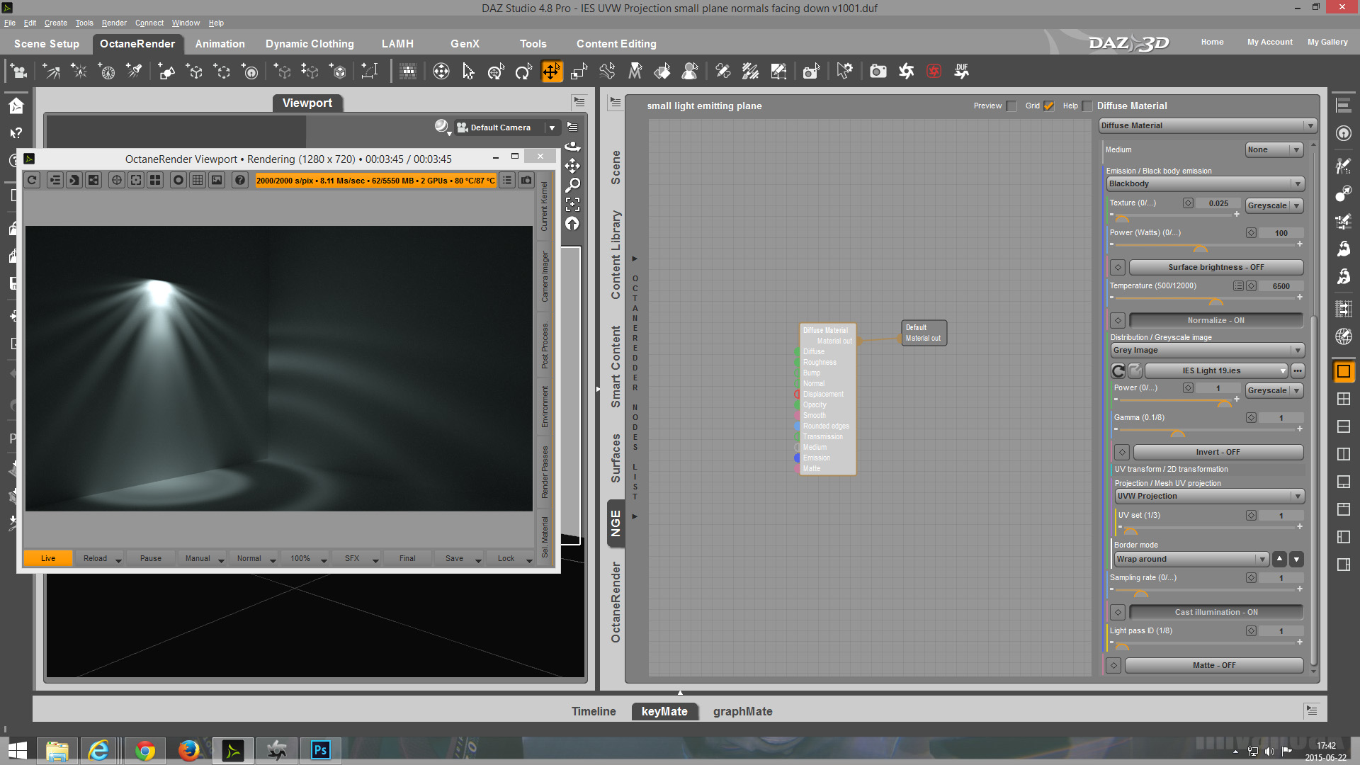

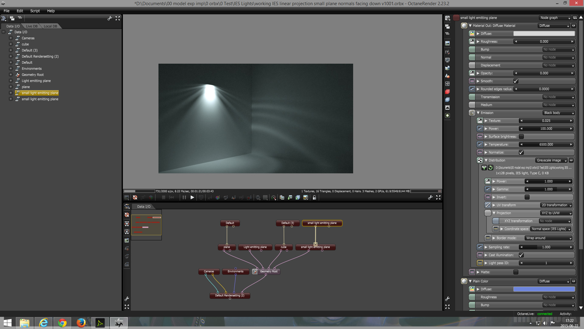

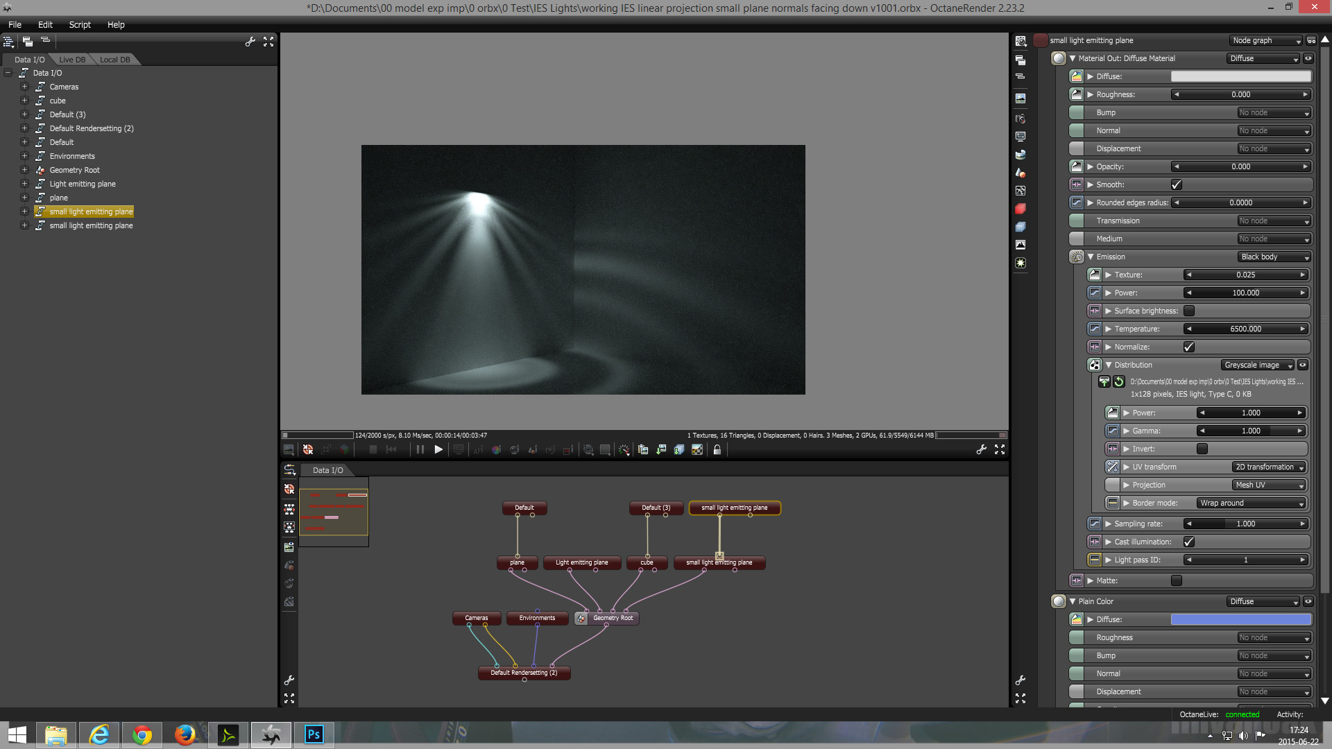

Update/ Edit 2015 06 22:
birdovous figured it out and shared the result:
- use a small plane as light emitter
- orient the normals of the plane down to the floor if you want the light streaks visible on a wall as in the IES preview image.
- In OR standalone the Mesh UV projection seems to yield to result that is closest to the IES preview image.
compare OR standalone manual:
http://render.otoy.com/manuals/Standalo ... age_id=901

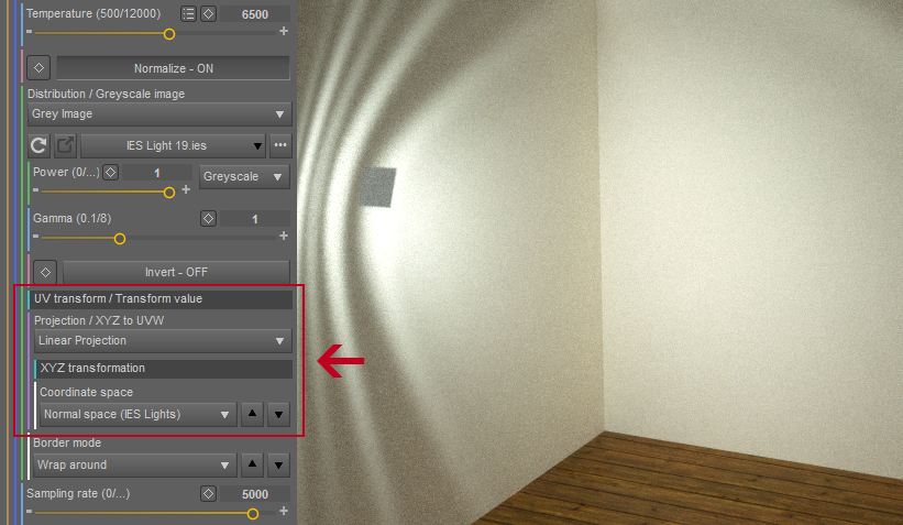

In order to link the IES light direction with the object normal direction you need to activate
"Projection" - "Coordinate Space" - "Normal Space (IES Lights)"
Once this setting is activated rotating the light emitting object will also rotate the IES light direction in relation to the normal direction of your object.

I can observe the same behavior.
Rotating a prop does not (anymore?) seem to have an effect of the orientation of the IES light without changing additional settings.
This may have worked similar with the Orientation settings in the past though.
@ Orientation settings were replaced with new options
There was not only a name change to "Emission pattern" but also basic IES functionality seems to have changed in one of the 2.x standalone updates.
In the past IES lights had Orientation settings included to change the direction of the light.
Those seem to have been exchanged with another functionality called Projection.

New IES Settings "hidden" under Projection and Coordinate Space
It seems there are additional options hidden for IES lights under "Projection"
Depending on which Projection you select there appears an additional pulldown menu for "Coordinate Space"
There is a setting for "Normal Space (IES Lights)"
When you activate this in theory now the IES lights should point in the direction of the normals of the object you are using.
Additonal information:birdovous wrote:I think I nailed it
These are the settings that seem to work for me in the latest version of the OcDS plugin (see screenshot).
Projection has to be set to Linear and then Coordinate Space can be set to Normal Space (IES Lights)

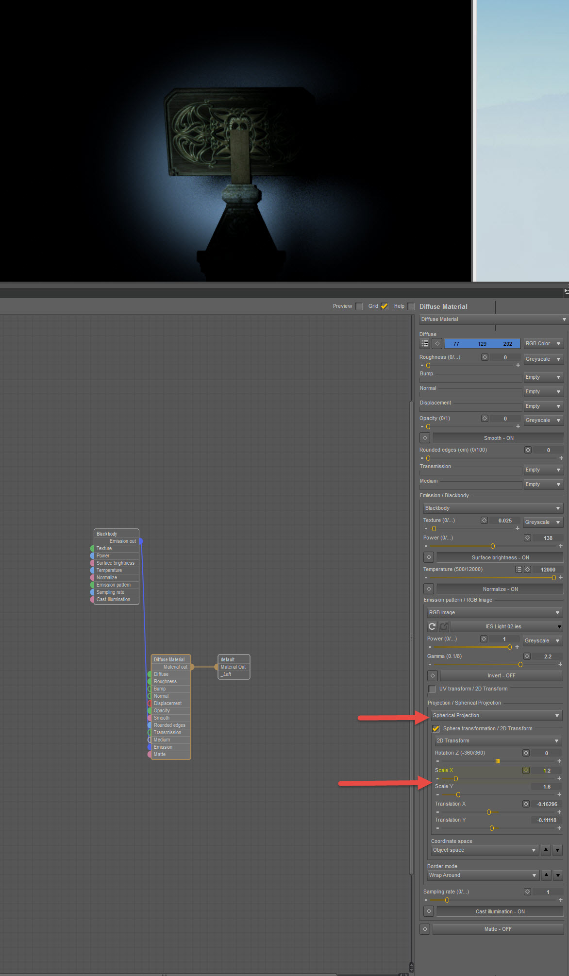

Thanks for the detailed explanation, it helped me figure out the problem.
I needed to have a small spot light point at an object and no where else with no light leakage. I was able to accomplish this see image below, and was able to change the size of the spot light. Very important if you want to highlight someone eyes only.
You can do this using the spherical projection and scale.
Let me know if you have any questions.

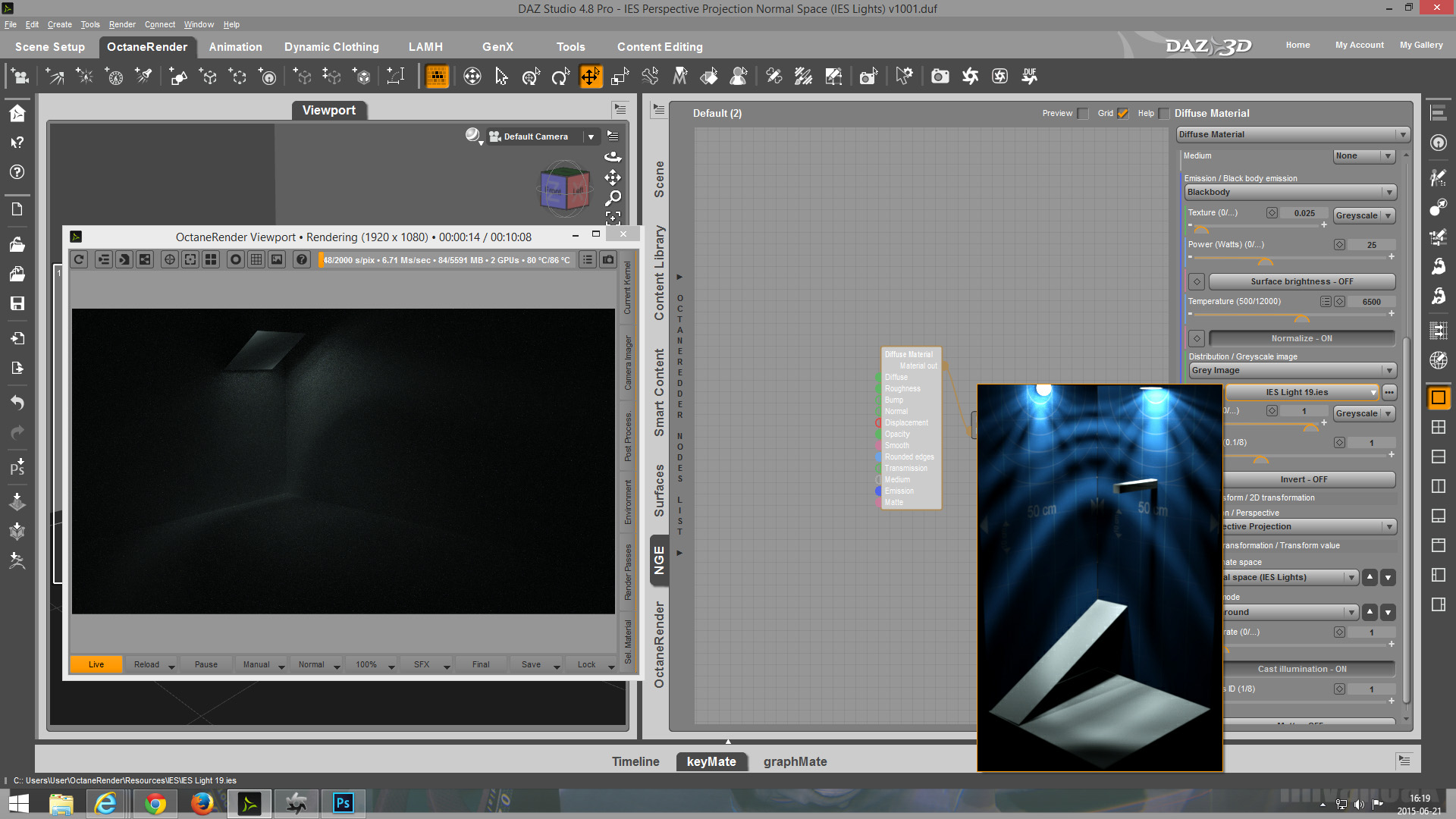

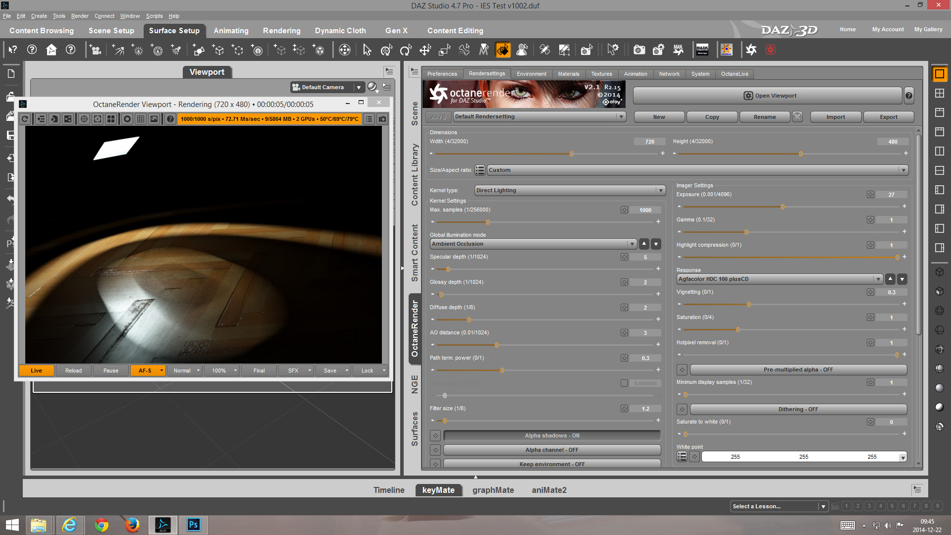

I dig up this old thread.
It seems still the same issues are confusing users.
Any information either by fellow forum users or official amins, staff, plugin or standalone developers would be very much appreciated.
What was the official intended way how we are supposed to combine IES light presets with projection so that the result looks like in the preview images of the IES lights?
In theory:
In practice:
- I now tried around more than an hour again and still have not found the proper settings to actually make the IES lights appear similar like in the preview image.
Which is the official and recommend projection mode to be used with IES lights?
Which exact settings need to be used in combination with the IES presets included in OcDS to make them appear in the scene exactly like in the preview images?
Example:
Update/Edit:
Now obsolete speculation removed.
I added the test scene. One file for OcDS and one file for the standalone.
So anyone interested in figuring this out, creating a step by step guide or sharing results has a quick way to get started.

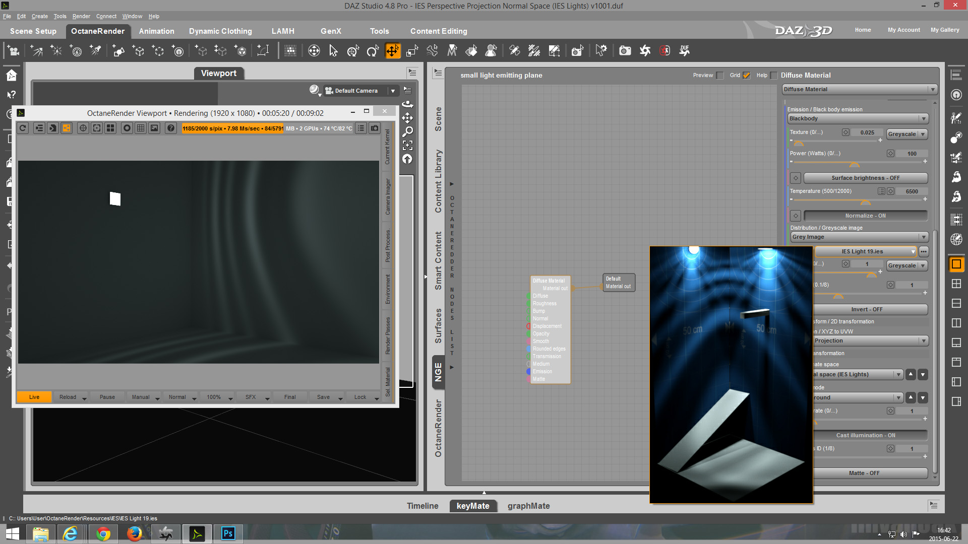

Update/Edit:

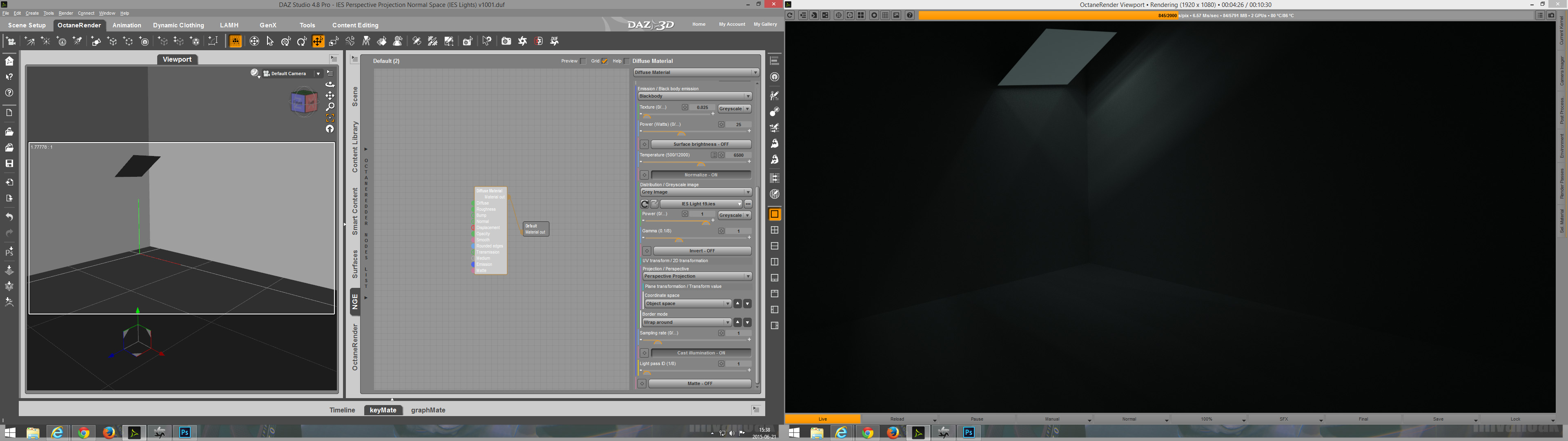

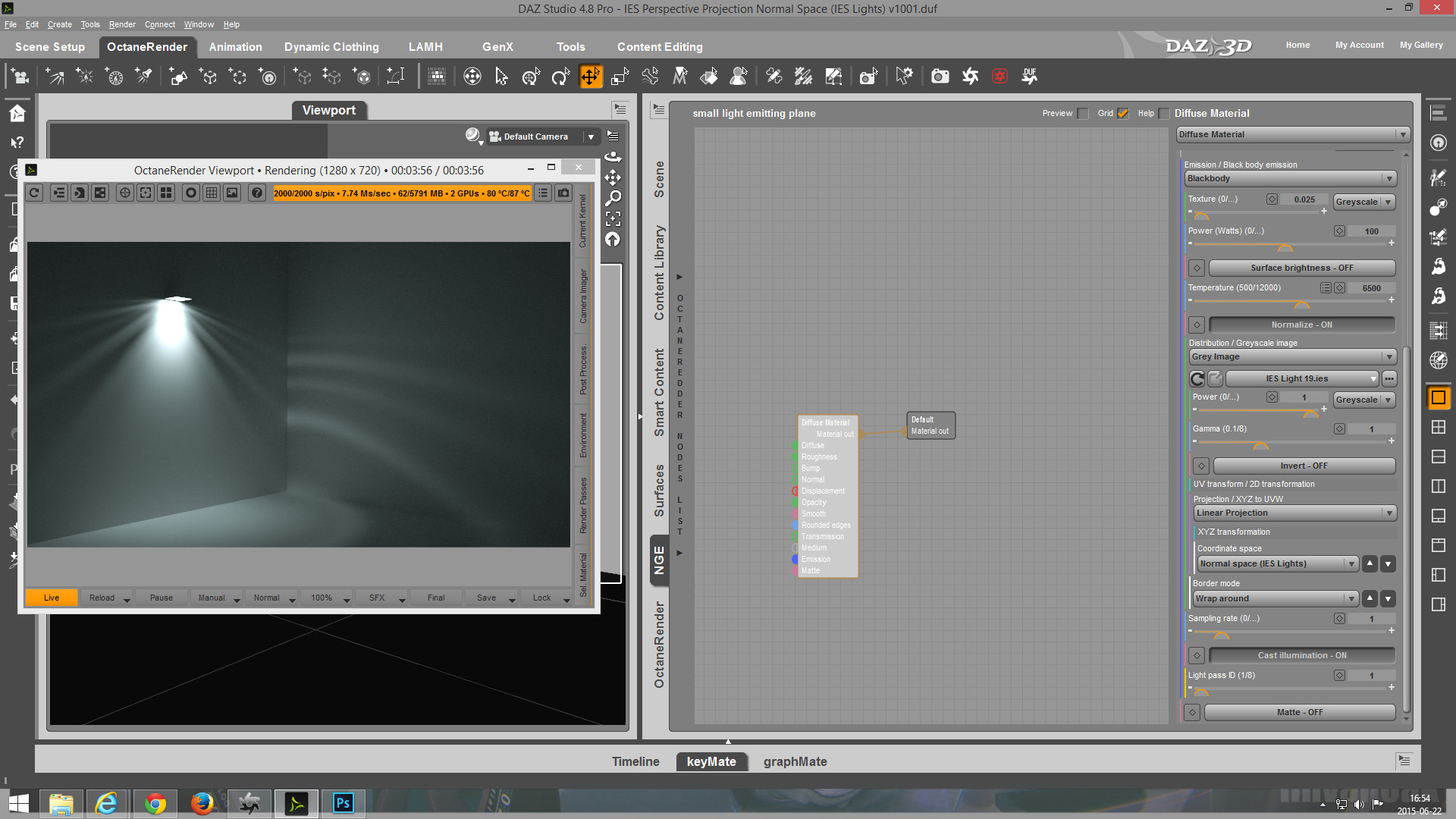

I think I nailed it

Yay you did it!!! Thanks a lot for helping and sharing your results!birdovous wrote:I think I nailed it
I noticed that you used a smaller plane and this also helped a lot to make the effects more visible!
For the first test with linear projection I made a smaller plane and lined it up with the wall so the normals of the plane face away from the wall.
The effect I am looking for with IES 19 is that visible streaks have their original at the light source.
At the moment it looks like some wave like circles are cast at a distance.
So there still seemed one detail missing.
I now oriented the light emitting plane so the normal actually points down to the floor.
Now it looks pretty much like in the IES preview image.
The last step now would be to actually lower the opacity of the light emitting plane to zero so it is invisible and only the light effect remains.

I still wanted to figure out the proper settings for OR standalone so I kept experimenting.
After exporting the OcDS scene to standalone I noticed some differences.
I then tried around further in OR standalone and consulted again with the OR standalone manual
I than choose the "UV Mesh" projection that seems to be missing in the OcDS plugin projection options:
To me it seems like the Mesh UV projection does yield the result that is most close to the IES preview image.
In OcDS the Mesh UV projection is currently called UVW projection.
Different Projection Names used in OR standalone and the OcDS plugin:
It seems what is called Mesh UV projection in OctaneRender standalone is called UVW projection in the OcDS plugin.
What is called XYZ to UVW Projection in OctaneRender standalone is called linear projection in the OcDS plugin.
It may be after all that Projection in the OcDS plugin works the same as in OR standalone but the settings are just named differently.
Sometimes DAZ Studio limits how some options are implemented in the OcDS plugin.
I will write a PM to ask t_3 if in that case it is possible to use the same names as in OR standalone.
Update / Edit:
Allready got a reply from t_3.
The different naming can be considered a bug.
There were some limitations how node names were generated that now can be updated with the current version.
The linear projection found in OcDS is translated to a XYZ to UVW projection without any XYZ transformation node.What I knew before was that the OcDS plugin and OR standalone seem to have different projection options:
In OR standalone you find:
- Mesh Projection.
- XYZ to UVW Projection.
In the OcDS plugin you find
- UVW Projection
- linear Projection
Update / Edit:

Fixed in the next release.It seems what is called Mesh UV projection in OctaneRender standalone is called UVW projection in the OcDS plugin.
