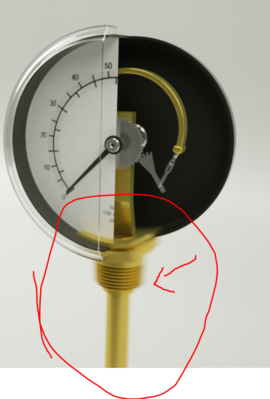

There used to be an issue with the first frame of a scene with moblur and random non-animated objects blurring, then the rest of the frames being fine. Seems I'm having the issue again with 2.14

are you on R15? I suppose that's a bug of C4D. Symetry and some objects cannot produce previous key frames on our methods. It should be fixed on R16. Btw, a workaround that convert this boolean or symetry objects to polygons.

Using r16. We're always on the latest version. It is an older scene though, that's loaded into r16, so maybe that's why.
