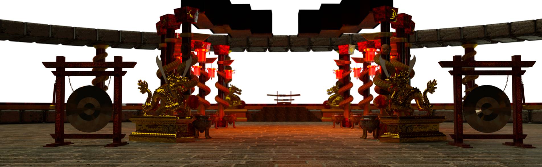

I am having several issues first what I get in the Live viewer is not replicated in the final render - the final looks horrible compared to live viewer

weird off color edges messed up

I know I am rendering to a bigger size to the final over double the size but its really blurring out and the lanterns look totally differnet

1:) why don't the renders look the same

first you should read faq for getting some answers. About "horrible", i think do you mean black background and pixels on edges. Check alpha channel option and test it in photoshop. It should be well.
