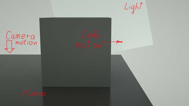

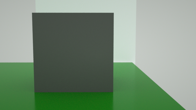

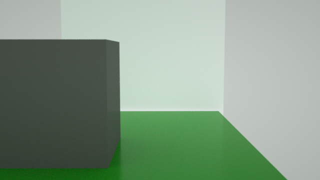

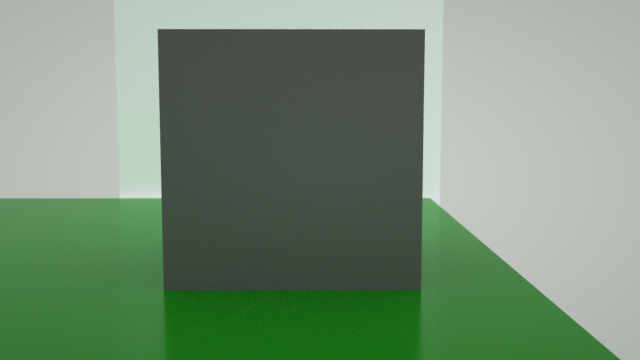

So I continued playing and managed to render motion-blurred animation from first attempt. I did 2 versions: with camera MB and object MB. Camera MB seems to be correct. Also checked the generated Alembic file - seems it has all what I need currently. That was good part :)
What's not so good :)
1. Animation of object visibility doesn't work. I have simple cube object that is invisible in the first frame, then become visible in the seconds, then again disappear in the third. All works OK in Carrara's 3D view but in Octane cube never show (regardless of MB settings).

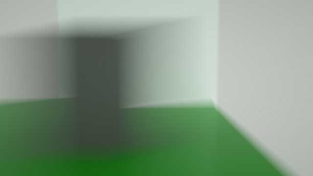

2. Now to MB, first let's see scene without MB, cube and camera are moving, other objects not.
Now we switch both object and camera MB on:

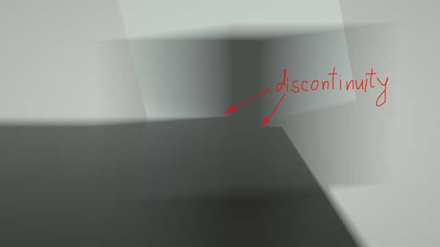

See how the edge of plane is drawn behind the cube - it's too sharp and has discontinuity. Will see how this will affect 'real' animations when port them to Carrara from DS.
This looks like a problem with octane and not the plugin. Can you send me a copy of your test project and I'll forward the problem on to the Octane Team.

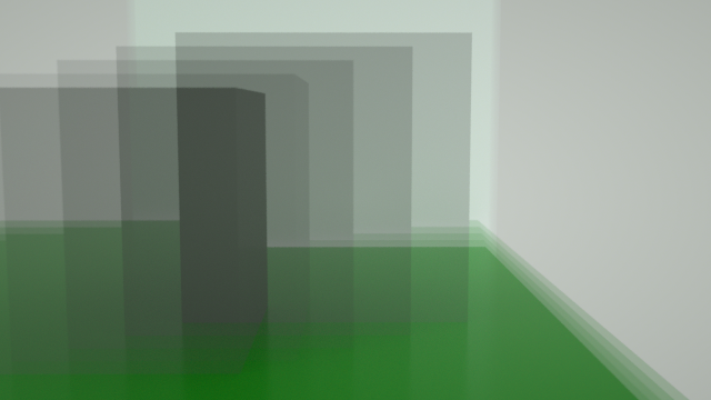

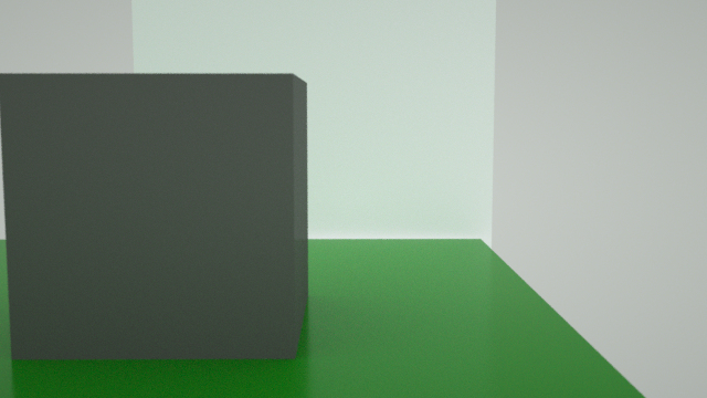

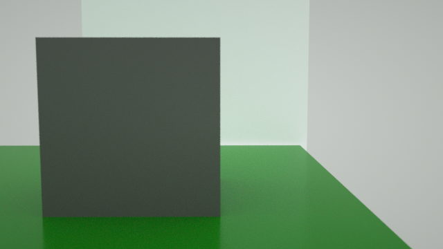

asennov wrote:The project file is in the attachment. I've altered it a bit so effect is more visible now:
The attachment mb_2_web.jpg is no longer available
Understood about 'animation mode'. Are there plans to integrate with batch rendering already available in Carrara ?
The motion blur behaviour is correct. As a test, I rendered 1 frame using non-blurred sub-frames and then blended them together:
As you can see, the discontinuity is a consequence of when the table is visible behind the cube.
