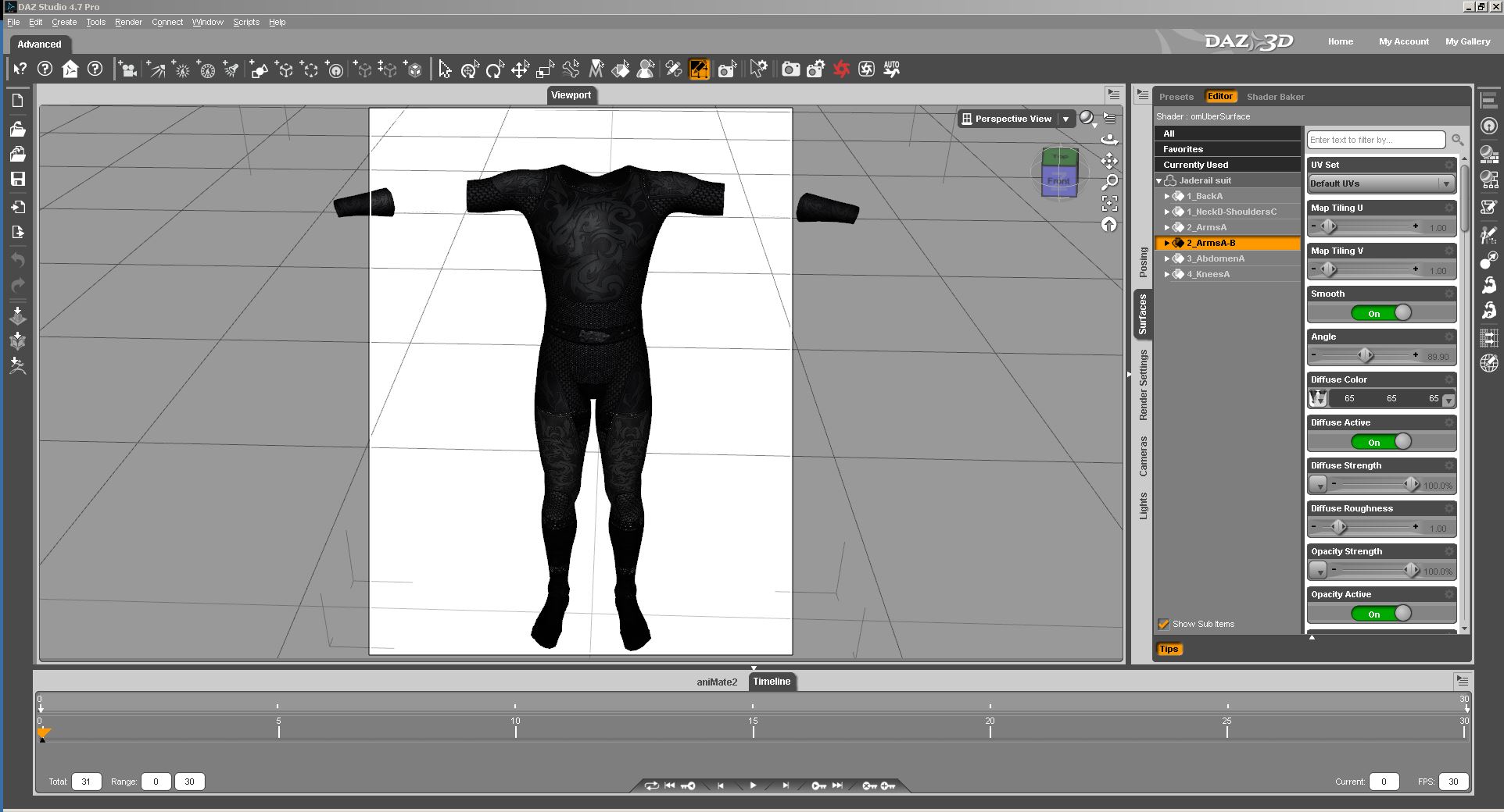

I modified the DAZ supersuit heavily combining surfaces and deleting polygons and saving as a new support asset.
I dd so largely with Octane in mind as it had so many surfaces.

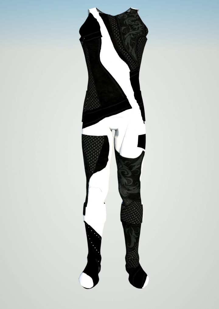

it renders fine in 3Delight still and an exported FBX on a figure retains its UV mapping in iClone but for some reason it is all messed up in Octane?
I am wondering how the UV mapping can change in Octane?
I see this often with geografts but those do that in carrara and iClone too and prob any other third party export, is due to shared polygons I presume, I only deleted polygons and did not add any or change the vertex count on remaining ones and just deleting has never affected UV mapping though it can rigging but in DAZ with polygon editor this has never been an issue so long as I retain the grouping.

an exported obj re imported works fine in Octane too and will load the DAZ material preset too, this issue seems limited to the rigged original which makes me think octane sees the face groups too not just the surfaces.
OK fixed it, I reimported that obj as a new UV set under surfaces.
