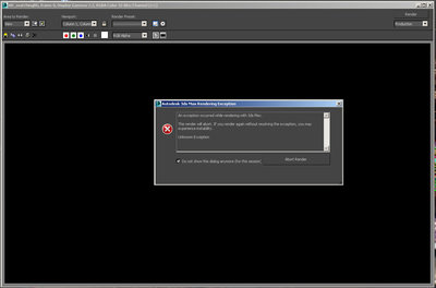

The footage shows nicely in the Octane Render Viewport, but when we try to render in Max, we get a Max Render Error (attachment below).
Is there a special trick to get this to work? Obviously we can render it without the background and comp in AFX, but if we could render straight out of Max, that would be more ideal for this project.

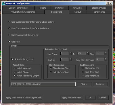

Here's the setup for the Max Viewport Background:

Understood.Karba wrote:Hi Oliver.Olitech wrote:Here's the setup for the Max Viewport Background: Best,
O
Unfortunately you have to use some compositing tool. you can't save images with background even in octane viewport.
