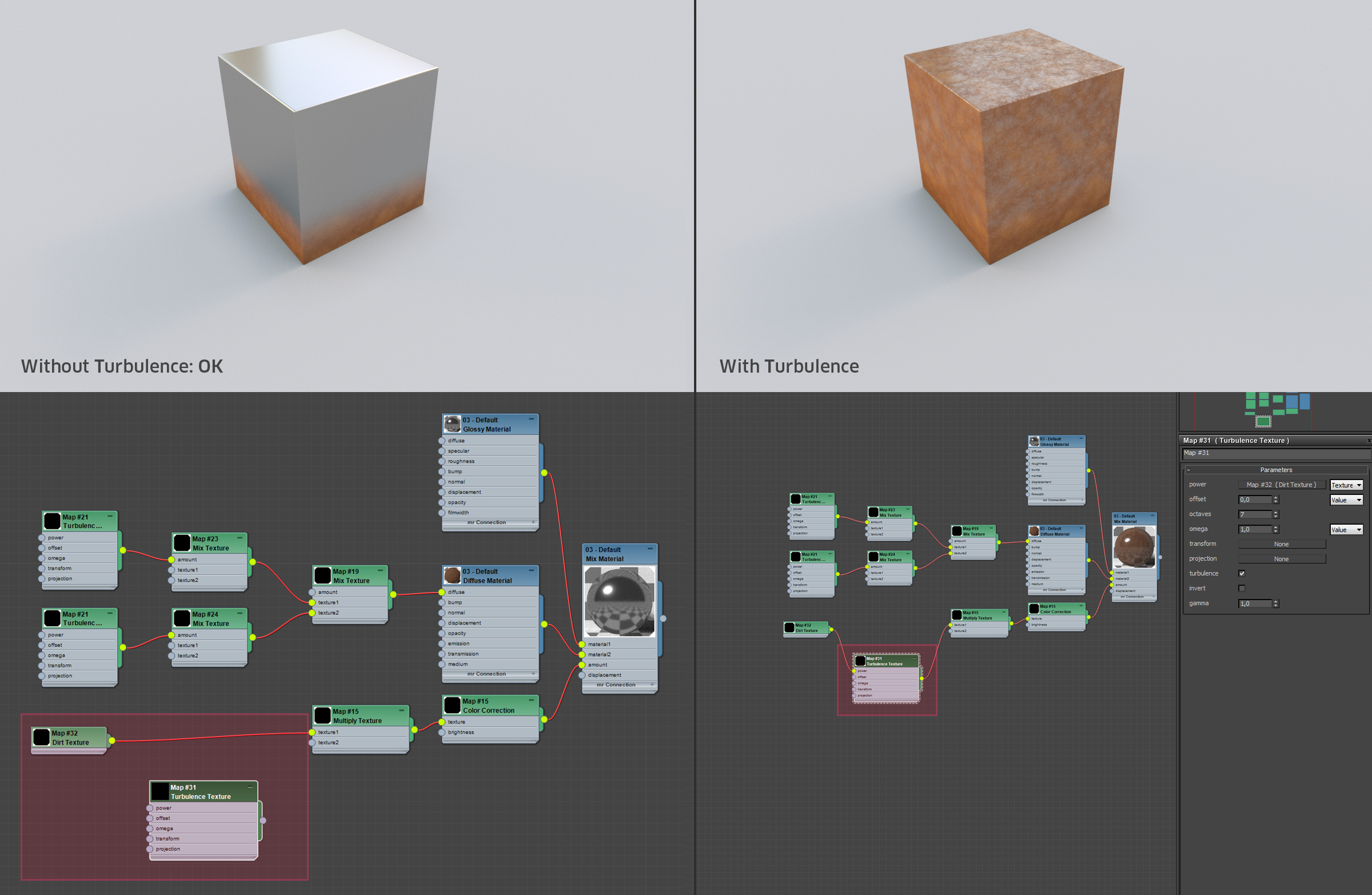

Trying to set up a material like this one:
http://vimeo.com/100085092
As soon as I connect the Turbulence Node to the amount the dirt radius seems to be ignored.

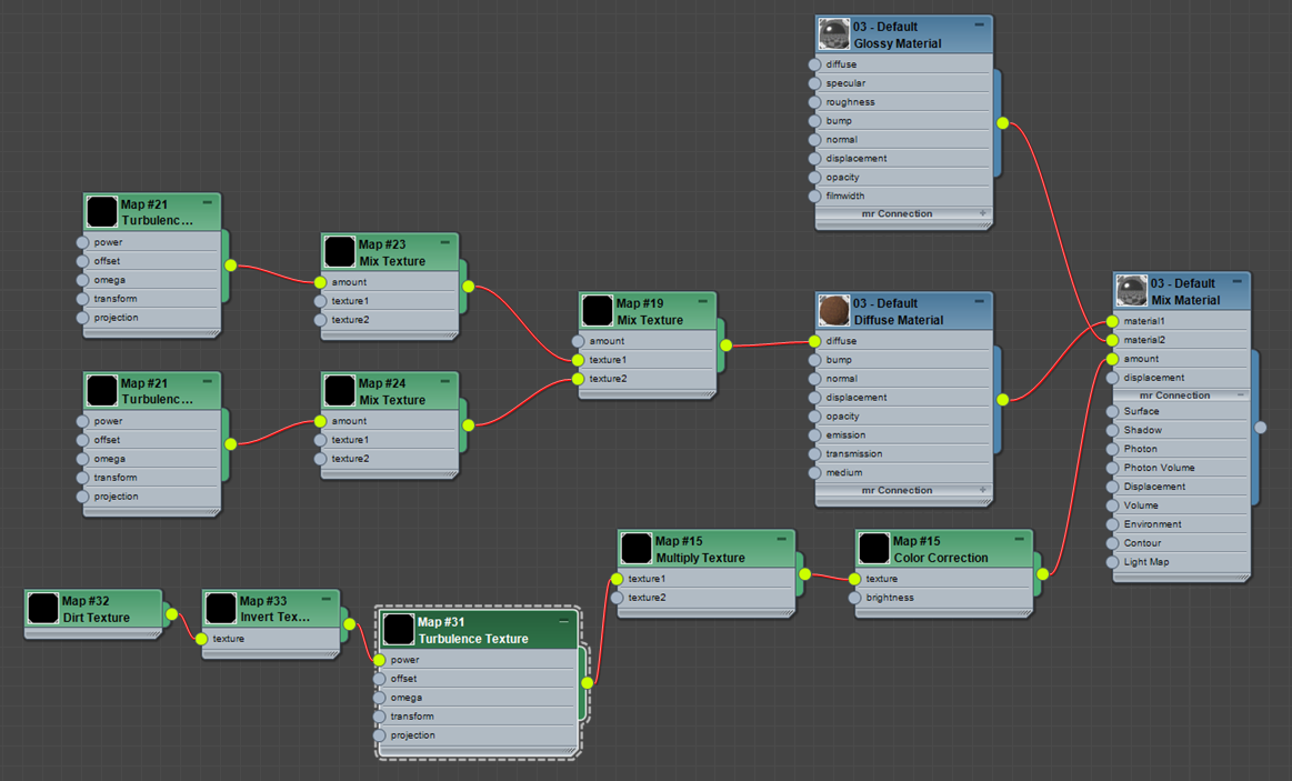

It looks like this is doing what it should.
I think the main problem is that the mix material works with value 1 = full 1st material and value 0 is full 2nd material.
So what you are getting from the dirt map is actually 1 = glossy/normal and 0 = rust part.
So, using this as the power of the turbulence, you get amount values everywhere EXCEPT the rust part (and i don't think this is what you are going for!).
Try running the dirt map through an invert (0 on glossy/normal part and 1 on rust part) and then swap the materials around on the mix material.
This might give results more like you are expecting when you run the inverted dirt map through a turbulence. It will have turbulence on the edges (where the inverted dirt map returns 1) and not on the main face (where the inverted dirt map returns zero). :?
Hope that is progress towards what you want?
