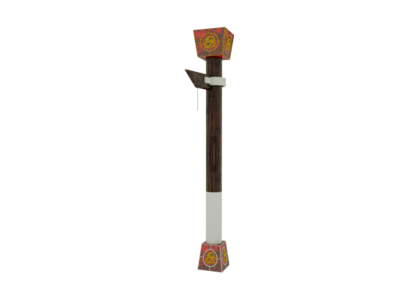

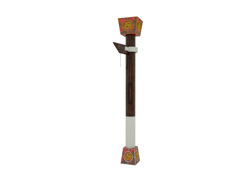

this is the pole once I turn on the cloner for 4 of them the render crashes - there are no big textures only downloaded octane materials

I solved the pole issue though I don't understand why I solved it

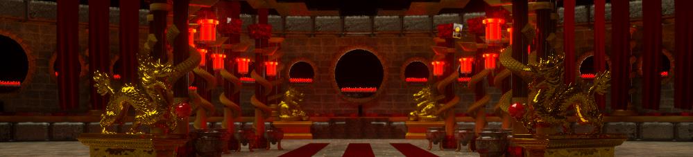

I had a subdivision surface on the dragons adding a level 3 more polygons which I guess could have jacked up the count a lot but I cant imagine it was more than the rest of my scene which has a lot of polys in those dragons
but now it seems to render without crashing that much entirely

I have replied in your other post. polygon count can't go over 20millions and check your big textures. check free vram on live Onscreen info. decrease polygon subdivisions and try your scene.
