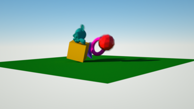

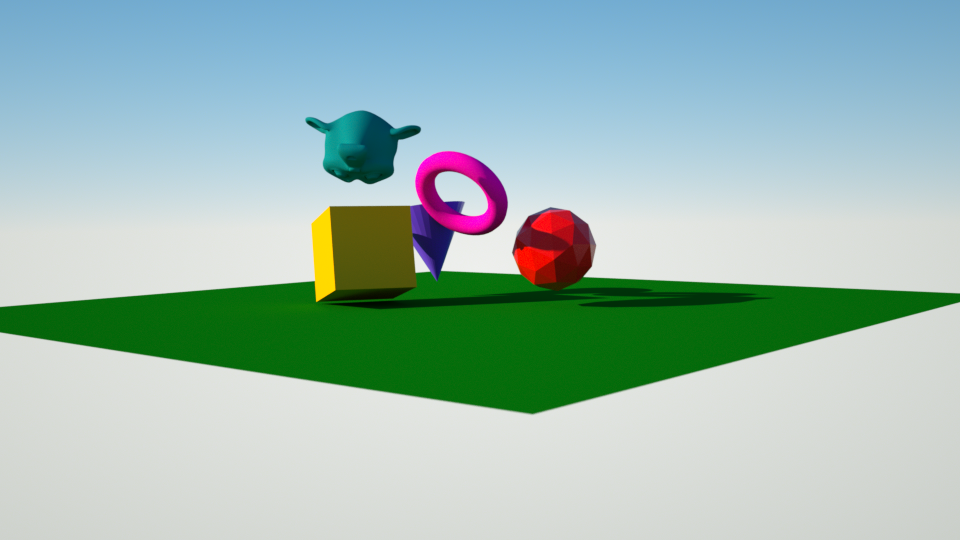

*sigh* Me being dumb again. Thanks Jim. :| Now that that is solved I'm still having a problem with the motion blur. Subframe works, internal does not:
Here is one of the images from the animation with subframe motion blur turned on:
And here is the same frame with internal motion blur turned on:
Both are using the same parameters. Am I missing something again? Well they should be the same frame. Part of the problem? Thanks,

JimStar
Posts: 3828
grimm
Only "movable" types will be motion-blurred on the rendered image.
grimm
Posts: 1332
Joined: Wed Jan 27, 2010 8:11 pm
Location: Spokane, Washington, USA
That worked, thanks Jim. :D Now I will go crawl back into my hole. ;)
