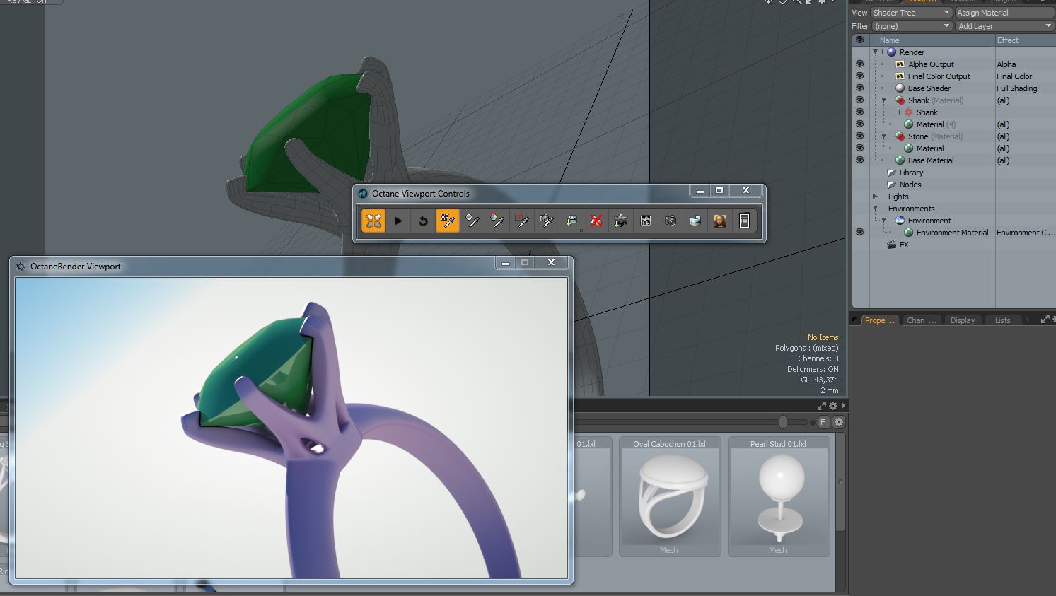

1)Camera. I'm having is that that I can move the camera via modo but how do I move it in the octane render window? Also, and maybe more confusing to me. The octane camera now seems to be completely uncoupled from the viewport? For instance in the standalone I drag sliders around like a mad man changing parameters and I see those changes take place REAL TIME. Now it's not until you move and release the slider that the update takes effect in the viewport??? This is awful, how can I fix this?
2) I have a gemstone on screen and instead of looking faceted it seems like octane is rounding all the facets so now the top of the stone looks like a cab (a marble cut in half).
I not sure what you mean here....are you trying to move the camera with a slider? The camera is sync'd to the current Modo render camera - so select the "(Render Camera)" in the Modo viewport, and the Octane viewport will be sync'd to it.
Turn smoothing off for gemstone material.

So what I mean about the camera is this. When I adjust the camera parameters with the octane viewport controls ie aperture, exposure, fstop etc. The effect does NOT happen real time and only takes effect once I release the slider?? In the standalone (and rhino) when you slide a slider the change is visible as you are making changes, inside modo this does not seem to be happening? Also and I'm having this issue in the standalone and all the plugins is that I have to change the aperture to zero just to get my object to show (working in mm) because otherwise my design is so blurred it's like it's not even there.
As for the gemstones not being faceted. I understand that's the smoothing option but I can't seem to find it to shut it off. I'm sure it's simply because I've not spent enough time in the plugin.
Most sliders in the plugin immediately update the corresponding Octane node pin value (material nodes for example), however some nodes (like the Camera, Post Processing, Imager and Environment) cause the original node to be deleted and then recreated - so this only happens once you release the mouse button. The reason for this is that re-creating these nodes requires the use of Modo API functions which are not available in the "slider move" Modo event. So the slider events get stored up until a Modo "idle" (ie. the user has released the mouse button) event, and then actioned. So this is really a Modo API limitation - sorry.
If there is no Octane Override for the gem, set the Smoothing % of the Modo material assigned to the gem to 0. Or even better - add an Octane Override for the gem material, and then select the (presumably specular) material node and untick Smooth.
