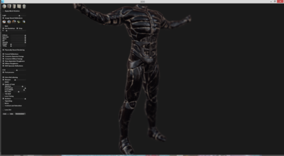

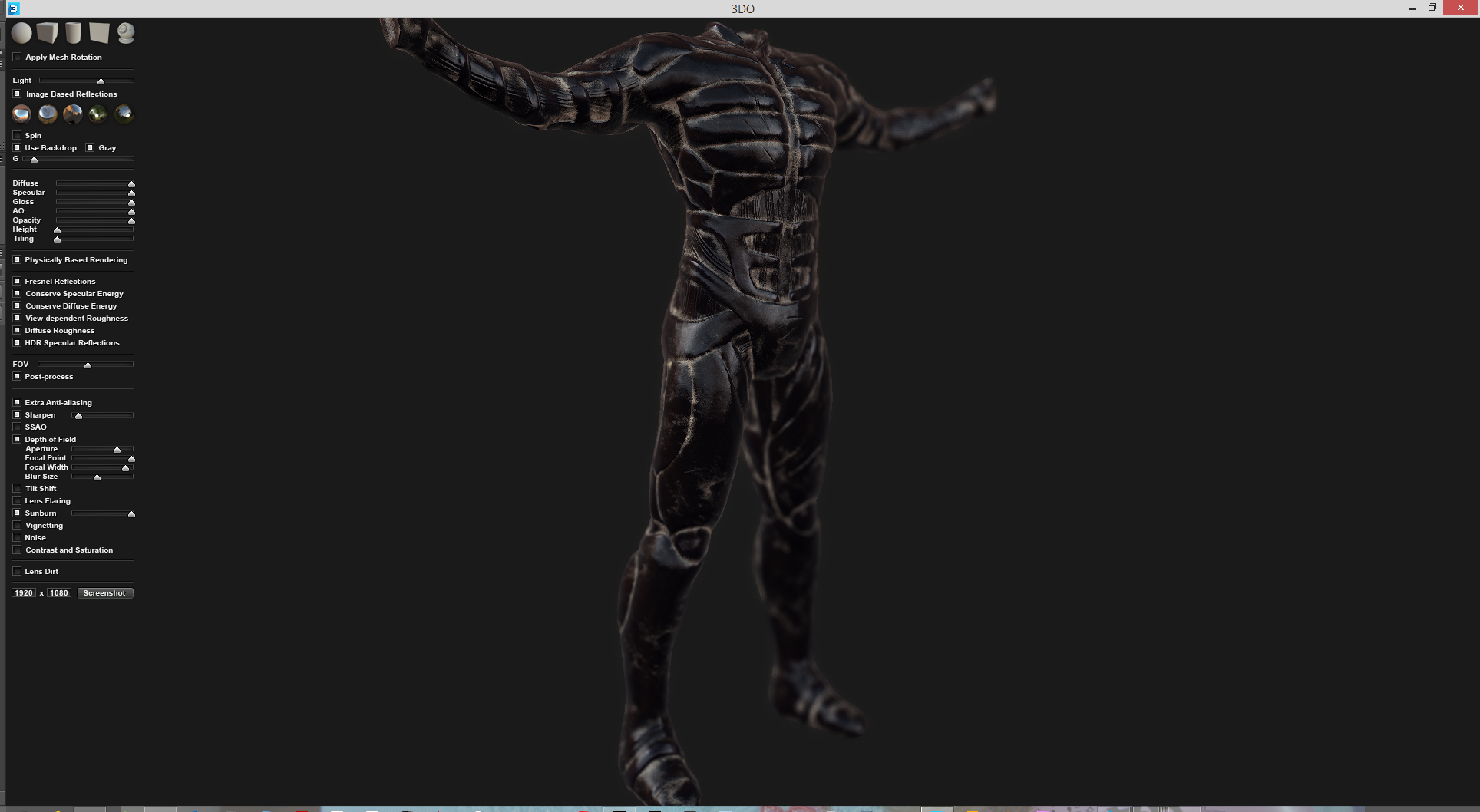

Was owndering if anyone was using Quixel Suite or dDO for textures to render in Octane. I've having a real problem getting it to work properly. I get a great look in dDO, but then am having to messiw the spec and roughness (glossy dDO calls it) to get it to look anywhere like as good.
This is how it looks in DDO

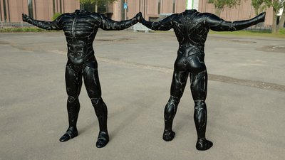

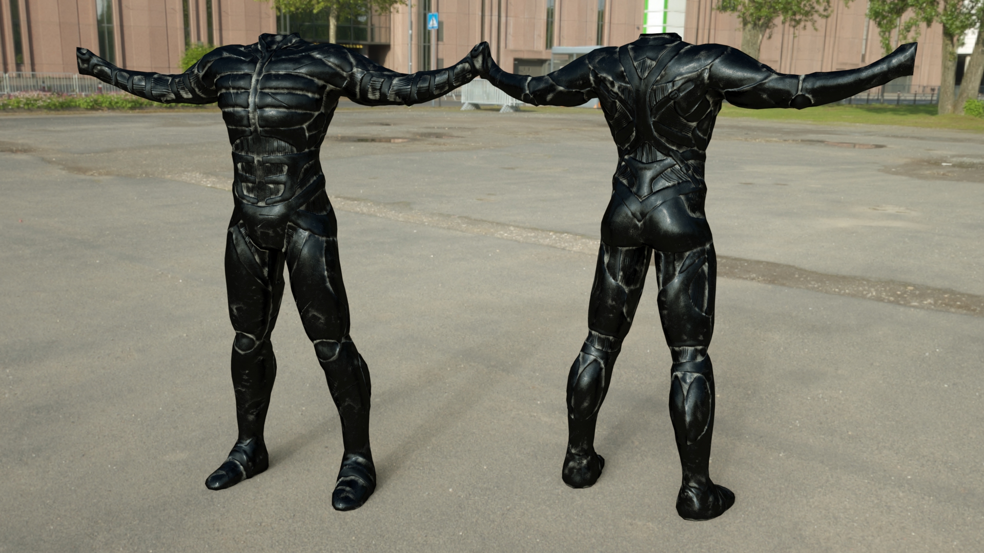

And this is the closest I can get it in Lightwave Octane. And only then after a lot of messing with the maps.

Use the spec/gloss texture as a roughness node instead of specular on Octane with gamma 1, that's what I personally do.
Remember that these tools ( I use Substance Painter/Designer on my side) are also made for game engines like Unreal Engine 4 and Unity 5 (for example, U5's BRDF does not contain IOR slider) and you have to take that in count.
There are probably better way but it really depends of your exporting, as sometimes it can export the roughness as alpha channel etc. :)

I've actually got it sussed I think. I have found an export profile that exports the gloss map as a roughness map that's the right way round for Octane. :)
Tell me what you mean about taking the IOR into consideration though?

Gordon, what export preset are you using? I found i had to invert the glossy map and plug it in to the roughness map and that seems to work well. I´m using Generic PBR.

I can't remember off hand, but there is an export setting that exports a roughness map, rather than glossy. And it doesn't need inverted.
