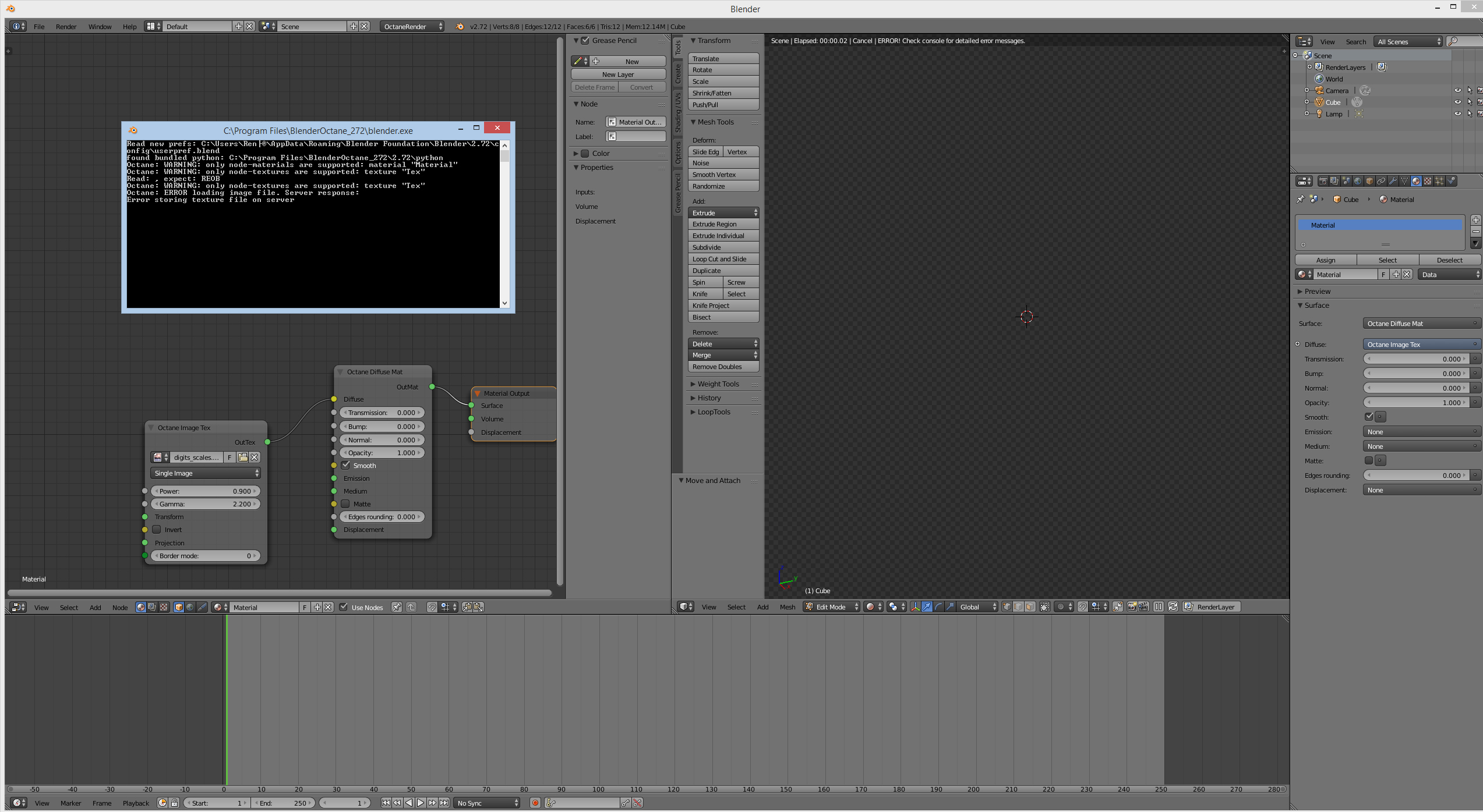

Everything works fine up to the point I want to load up any image texture to any slot.
In the attached example, the cube has only one material. In the diffuse slot an image texture is applied.
Suddenly the console says that it cannot load the image file to the server.
What am I doing wrong? The Node system has changed a lot since 1.20 :?
Thanks for help.
René

Look at the user-directory of the user under which you are running the OctaneServer. Is there "livedb\client\textures" directory present?

yes, it is there. And all other directories too.
The Material LiveDB is not available. Neither in the Plugin, nor in the Standalone.
But at least in the Standalone I am able to add a texture to a diffuse node.
The Firewall is deactivated and there are also writing permissions within this folder structure.
octane server 2.8 is still running without any problems. could there be a conflict if both versions are installed?

regionfive wrote:The Material LiveDB is not available. Neither in the Plugin, nor in the Standalone.
It's very strange. It looks like some network access problems may still be present... Perhaps some antivirus blocks these executables from network access?..
About folder permissions - to check if it may be the case, you may start OctaneServer "as Administrator" and check if the texture file problem still exists. This is really weird issue, as nobody reported anything similar for all the time Blender plugin exists... :?
regionfive wrote:octane server 2.8 is still running without any problems. could there be a conflict if both versions are installed?
Installer places the newly installed executable files in place of old ones.
Are you sure that you have the Standalone 2.0 and the 2.0 standalone and plugin licenses activated on your computer?

Hi Jimstar,
I kind of "solved" the problem now. It was windows-wise.. obviously not an octane / blender problem.
After I made a new windows admin user account and logged in the standalone and the plugin licenses, everything worked fine.
There must have been some wrong settings regarding network or whatever...
You can close the thread.
