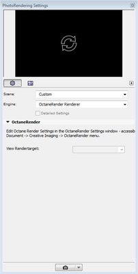

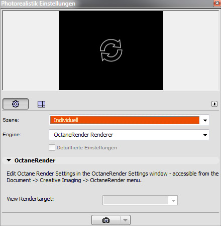

did somebody have the same issue? I can´t set the "View Rendertarget" at the photoreal settings, because it´s grayed out. :(
View Rendertarget grayed out
I have different views with saved rendertargets. I get all settings to each view, what I have set to the different views. It means, I have more Rendertargets in the projects and the default rendertarget.
The "View Rendertarget" grayed out causes two problems:
1. I cannot save the photoreal settings to the view. Although I have the rendertarget to the view, I can´t set it to a Batchrender with Publisher.
2. An animation calls the settings from the "Photoreal settings". I don´t have any chance to change the rendertarget. I tried several times, it takes not the default settings but something else what I have used before.
What did I mistake? :? I could use it before, it was AC-16-german + Octane-2.0. Now it is AC-17/18-german (the plugin should be pasted under Add-ons/Visualisierung).
If you open the plugin first - is it still greyed out?

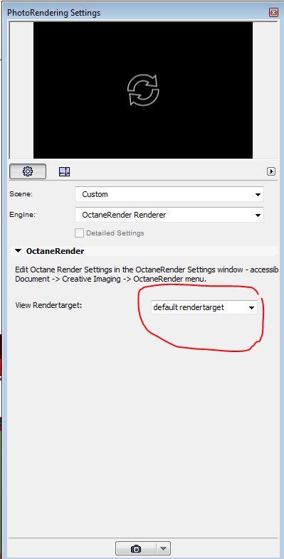

rappet
Posts: 1962
Joined: Fri Apr 06, 2012 3:57 pm
Location: The Netherlands
That is it!
I got gray when opening without having opened plugin first.
Paul, you are the man, again!
