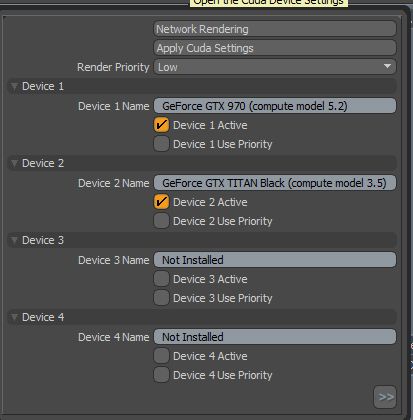

hello friends, I own a titan black and yesterday bought a gtx970 to help renders .... however when I try to render a scene in PMC an error occurs, and the octane starts using only the titan black as active board to render. ..if I put on path trace or direct light not occur problems...
here is the log
Started logging on 22.11.14 19:29:14
OctaneRender version 2.06 (2060000)
PMC kernel: Unsupported compute model (52)
device 0: PMC failed
its a simple sss scene with one ligh

if you guys want I can upploader the file so that you guys can analyze, however this is happening in all the files,
One more thing I forgot to mention that the gtx970 this set as my primary card

Hi - you need to use the 2.13 version of the plugin. If you look at the most recent posts in the TEST thread there are some links to the current test build (and I will be uploading an other version today). http://render.otoy.com/forum/viewtopic. ... 1&start=50
