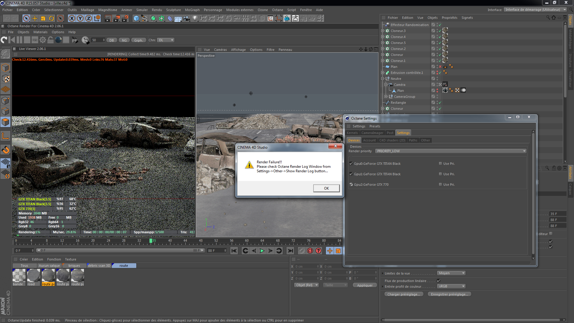

I'm using two Titan black before, and i have bought an gtx 770 yesterday, but if i turn on the 770 in the setting windows of octane.
I have this message (on the picture)
Why ?

Posts: 16063
Location: Türkiye
what do you see interestingly? or what it say?

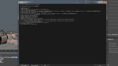

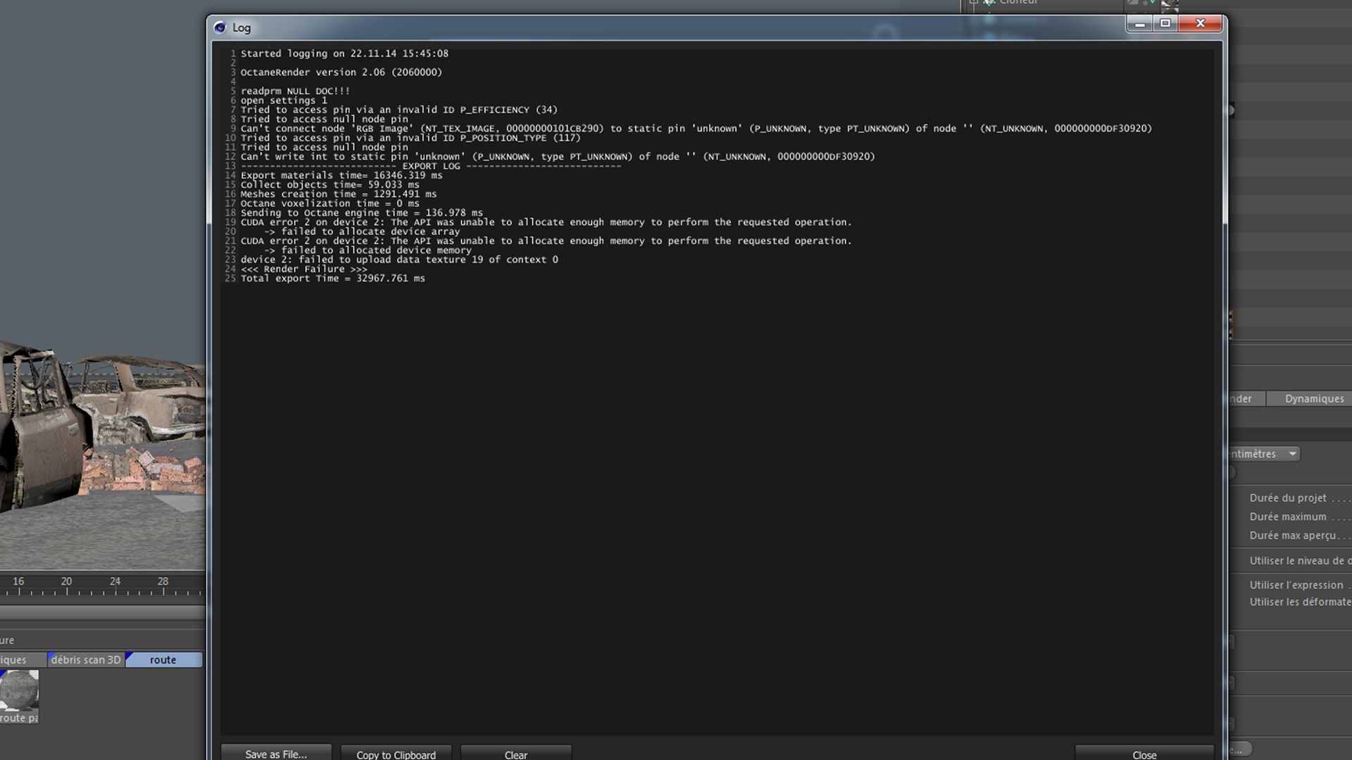

this is the report.
if i turn off the 770. the render work.

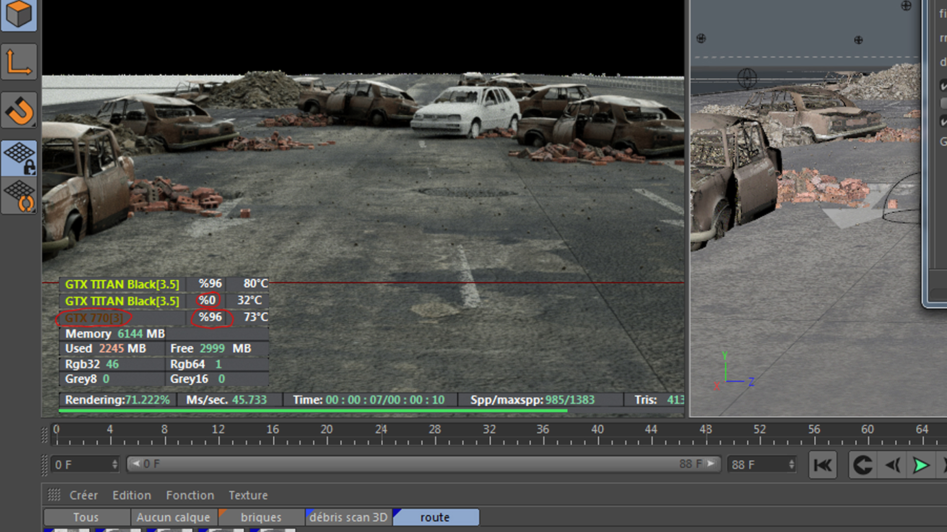

It's very weird, when i disable the gtx 770,
the i think the gtx 770 is using unstead of my titan
Posts: 16063
Location: Türkiye
it uses ram as lowest vram of gpus. it mentioned a few dozens times.
