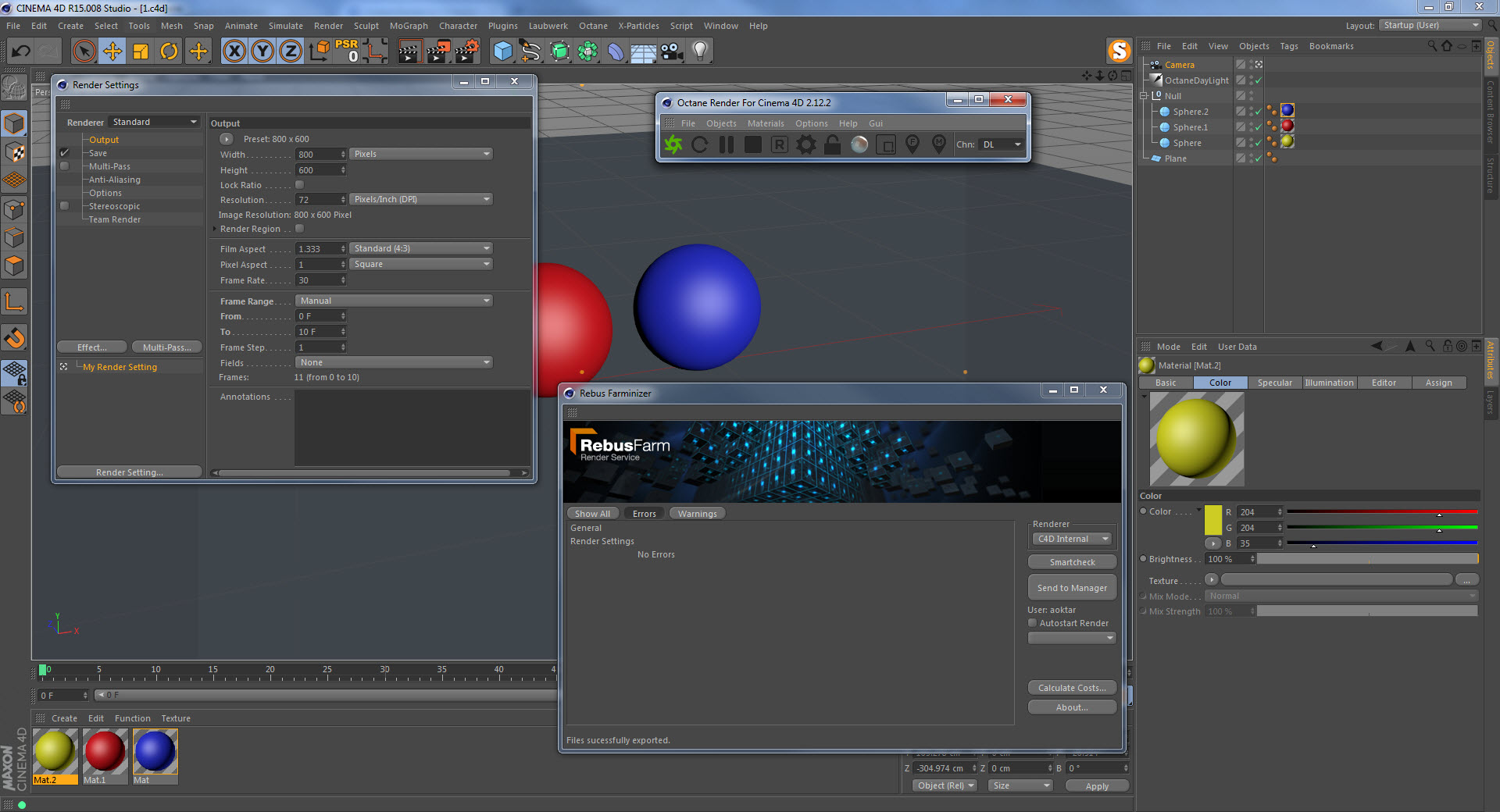

Ok, let me to do some test for renderfarms. Will take some time i think.
EDIT: after a quick try on rebus, it does not gives any error. Check attached image.

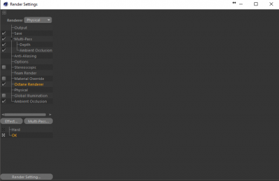

I did a test today and found a weird bug I want to explain:
1- Started a project using octane renderer
2- Switch to physical renderer, remove every octane material and tags
3- Use rebus farm and get the error message, that octane is not compatible with the render farm.

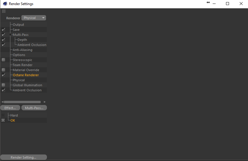

4-I am going to remove Octane from plugins folder but before that, look at my render settings:

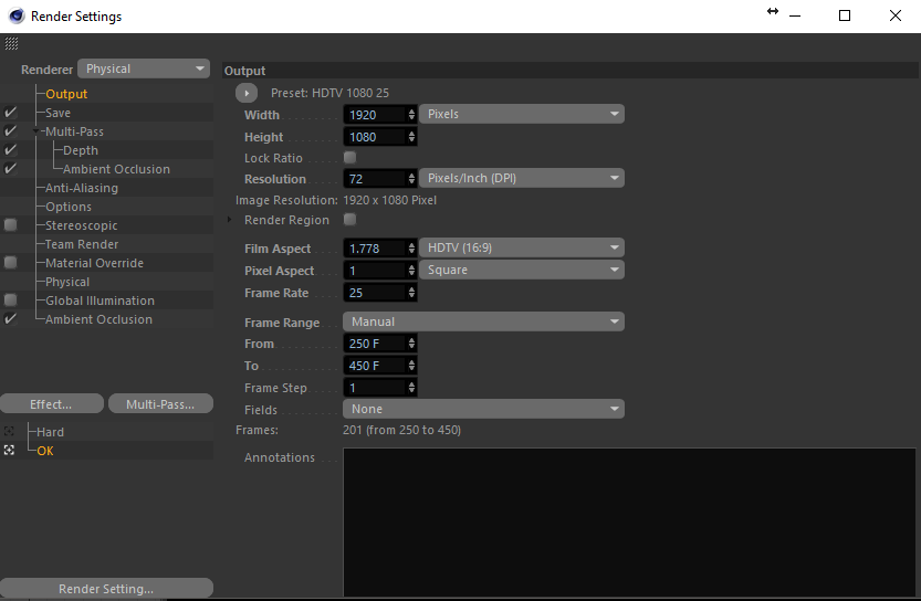

4-I remove octane from c4d plugins, open c4d and now look my render settings again:
It's weird that before removing Octane, it's seems there is a invisible octane attribute on render settings we can't deactivate, but appears if we remove the plugin.
I don't know it is a maxon problem and affect every renderer, or it is a otoy problem. I just want to share hoping it helps.
