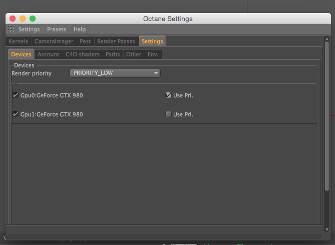

I'm sure something is wrong on your settings. Please show your gpu settings.muchogrande wrote:Same issue here. Appears more on scenes with larger/more bitmap textures. If I shut down c4d and open it again everything works fine again.

Thanks for responding so fast! These settings?
Yes, it is doing it on a scene with a fair bit of geo, but I am not using the Octane geo tag.

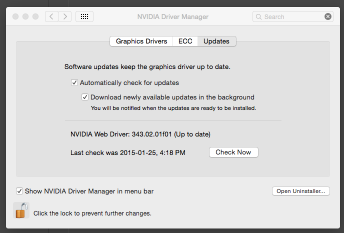

On OSX there's not much to see in the official nvidia System Prefs panel...? I haven't (don't know how) to change any settings on the cards.
