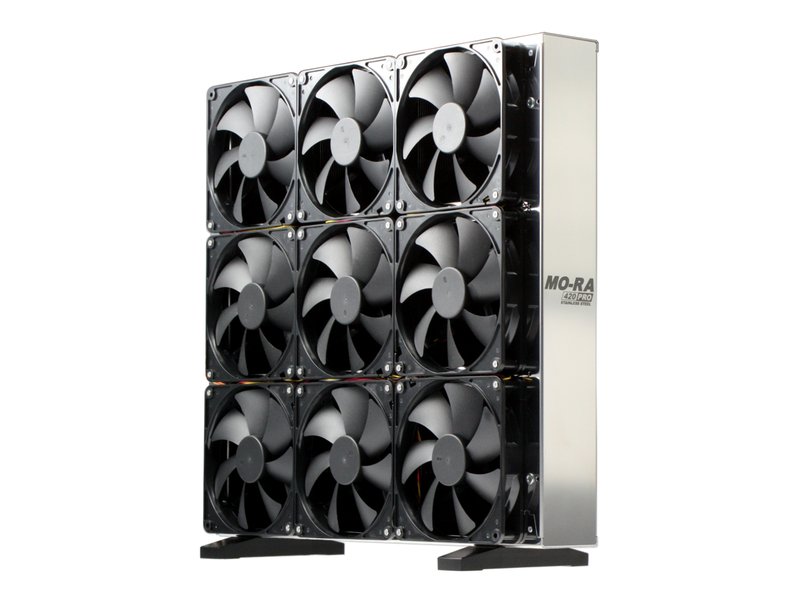

4x TitanZ with EK tops should take 8Slots, instead 12 if You go air-cooling route & that (8slot configuration) should fit into any case that have some extra space for rads or You can use "regular box" & quick disconnects to add 9x120/9x140 rads for proper cooling capacity.

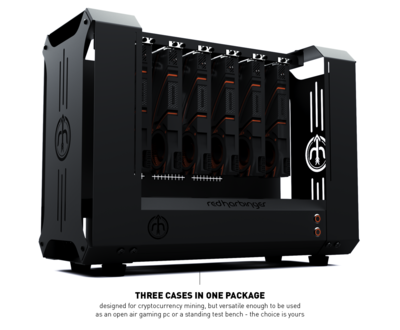

If You need some help, have predefined budget or any other guidelines, drop more info & we can try to find some solutions =) like using let's say DopoMiner (if You want to avoid water-cooling )
