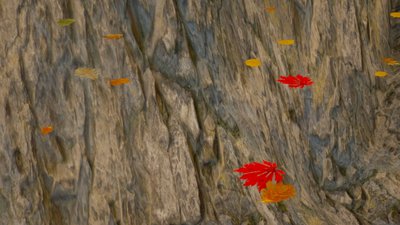

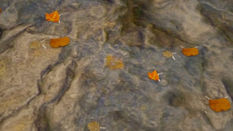

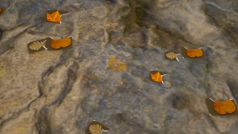

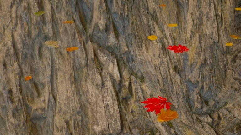

these leaves have alpha image on opacity map when they touch the ground that has mix material with dirt map leaves lose their opacity for some reason

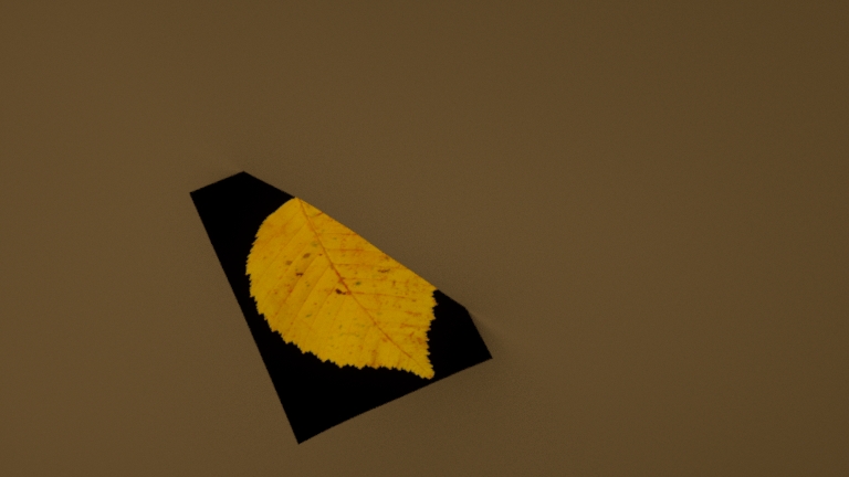

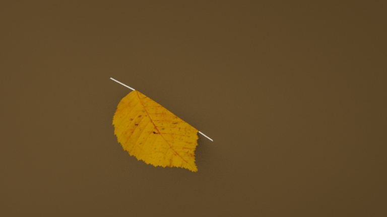

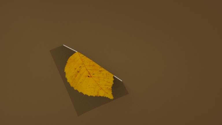

Here is more The brown terrain has Dirt map and this creates some kind of a white line where opacity is used
Image shows a leaf intersecting the terrain
Karba
Posts: 2300
coilbook wrote:Here is more The brown terrain has Dirt map and this creates some kind of a white line where opacity is used
try to decrease raey epsilon.
