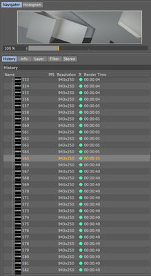

I have a problem rendering an animation. This is a very simple scene with just 2 moving extrusions.
Octane render the first 564 frames in 5s each and the last frames (436) in 40 second each.
Nothing is changing in the animation and between frame 564 and frame 565.
I use the last version of octane with c4d 15. I have 3 gtx 780 and 2 gtx 580. I use a PCI extension (netstor) on mac pro (10.9).
This is not the first scene i have this problem with.

If I restart the render from frame 563, all frames are render in 5s each. This is really strange...

with a gpu monitor program if macos has it. Btw, i'm testing with 100 maxsamples to finish quickly. I can't see any suspecious things on scene to cause speed drops. I think this is not a plugin related. Maybe a gpu problem.
