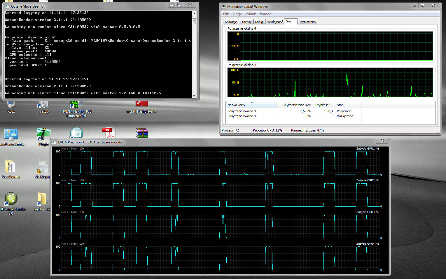

Dears!
I've got issues with Network Rendering from 3ds Max - OCTANE 2.11.1a.
I've got 4x GTX 780 on first machina and 4xGTX 780 on second machine - both with active licenses.
When rendering using Network, everything seems to look OK - I've got 4/4 Network GPU info, etc, but when I look
on slave machine GPUs are alnost not used, and if - with very, very long idle pause.
I've got 1GB Network, and use of it is about max 5% - so I think it's not Network problem.
What can I do to take full profit form slave machine GPUs ?
Best,
raffaEl

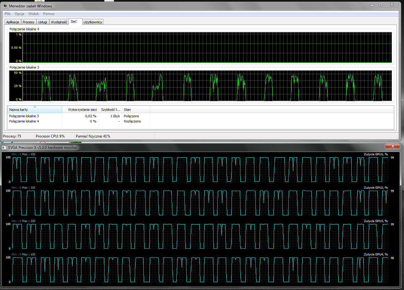

kcpr-raffaEl
Posts: 132
Joined: Thu Aug 14, 2014 12:10 pm
Here is how it looks like on slave:

gabrielefx
Posts: 1701
Joined: Wed Sep 28, 2011 2:00 pm
gpus are paused to send data to the master machine
every summed pass causes an idle time.
regards

kcpr-raffaEl wrote:Dears!
Best,
raffaEl
Is it a single frame rendering or you render an animation?
kcpr-raffaEl
Posts: 132
It's single frame.
6000pix wide.
Pathtracing Kernel.
Karba
Posts: 2300
kcpr-raffaEl wrote:It's single frame.
6000pix wide.
Pathtracing Kernel.
Could you try 2.13?

OK, it's much better!
Here is how it looks now:
I'm wondering if I would connect two 1GB network connections it could help more...
On Network activity performance doesn't even exceeds 50% of bandwith...
