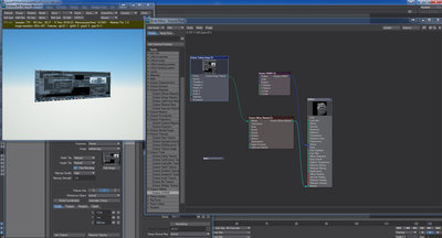

hi user, i've problem with this command.
why see black surface and not the image? i've this problem with all object!! :evil: - see Untitled-1.jpg
problem is with all "effect" node Type or Border Mode :!:

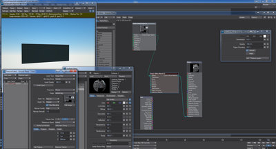

edit:

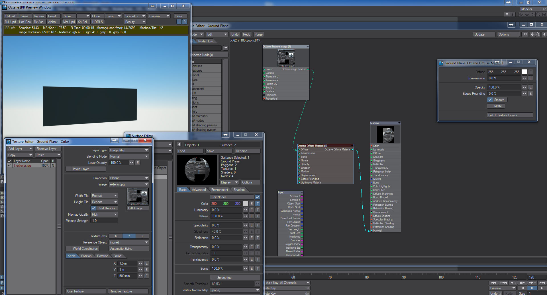

The get texture layers tool currently only works for objects and "T" layers using UV maps. If you need a custom projection at render time you are going to need to configure it by hand.
