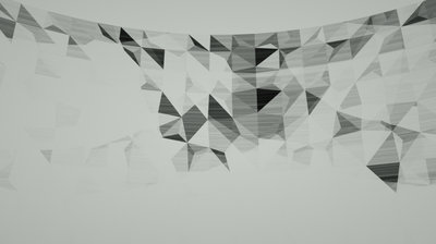

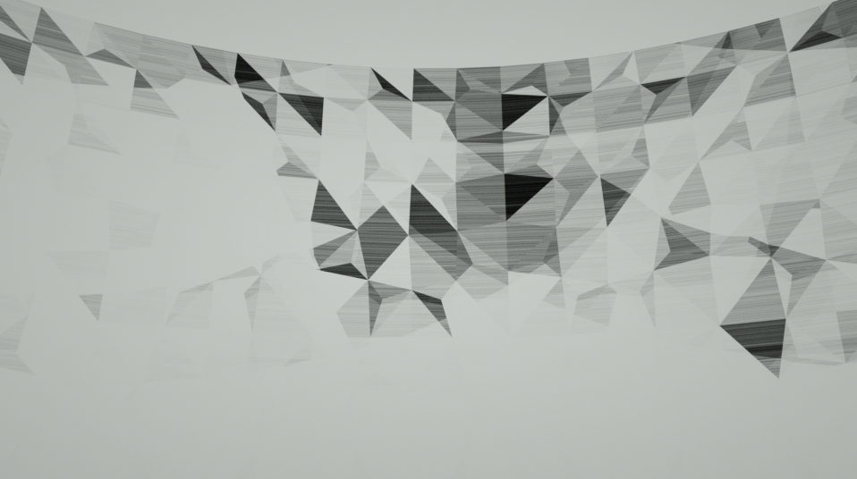

What's the problem?
Moderator: juanjgon
jang2235
Posts: 155
Joined: Tue Jun 17, 2014 2:04 am
What's the problem?
Test.zip
(953.24 KiB) Downloaded 169 times
juanjgon
Posts: 8867
Location: Spain
A problem with the scene scale, I think. Check the scene scale and/or tweak the "Ray Epsilon" parameter in the kernel node. Octane works in single precision floating math, so too big or too small scenes can be rendered with this artifacts.

In big scenes you should use a bigger ray epsilon, but it is better to try values for each scene until you don't get artifacts.
