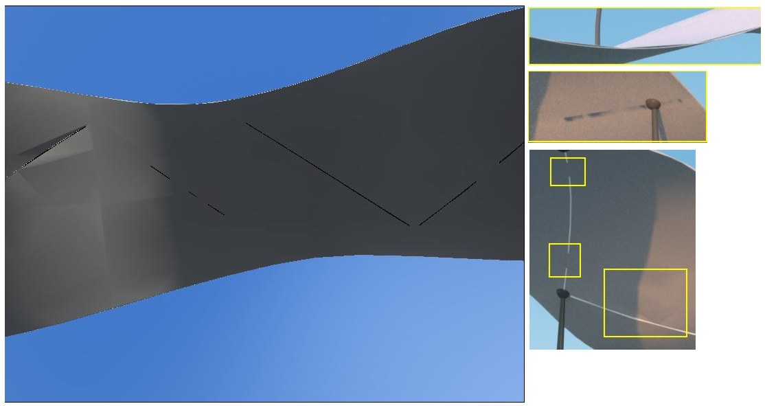

Do you have a solution for making a correct OBJ for using in Octane Standalone fromout Autocad 13?
That might be a solution for my problem.
My client is working with Autocad 13 and has modelled a very complex shape.
We are trying to exchange the model so I can make a nice viz,
but we are not able to exchange it correctly.
You can see the shape is having strange artefacts.
I am working with Archicad, and normally I can import (3D)-dwg, but it goes wrong with complexed shapes.

A little update here: I almost gave it up, but I have found a solution.
Only theis solution is not a general solution and it would be nice to have another way of exachanging.
I opened the dwg in Artlantis with adjusted 3D triangulation settings!
and the dwg had to be saved as Autocad version10 to be able and open it correctly.
And then export it to OBJ (after having materials tweaked a bit).

That is probably the best solution Jeroen. AutoCAD will not export to OBJ in a sufficiently reliable way to be of use in Octane.
