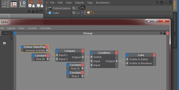

The trick I use is to automate the stoplights,
that way the timeline doesn't get cluttered with keyframes.
Put an Xpresso on the object that is fading,
so it hides the object (red stoplights) when visibility hits zero.

thanks for xpresso. I can hide when visibility=0, but i'm not sure it's safe way to go for all people.
EDIT: Visibility=0 will ignore exporting the objects on next version. I hope that not causes any problems.

Thanks for the setup, I ended up just manually animating the object's stoplights because it only had to happen once.
