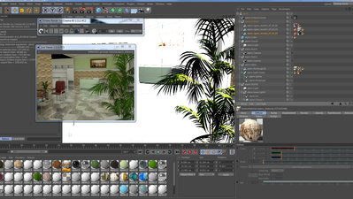

Maybe it hasn't been discussed.
When I use an XRef object, and this object is a model with some Octane materials, the maps for materials don't upload along with the model.
So I get a model with a material (as XRef material) but diffusion, bump or any other maps are not being uploaded (normally they stay in "tex" folder where the model is).
Is it an issue or did I miss some setting?
cheers!
