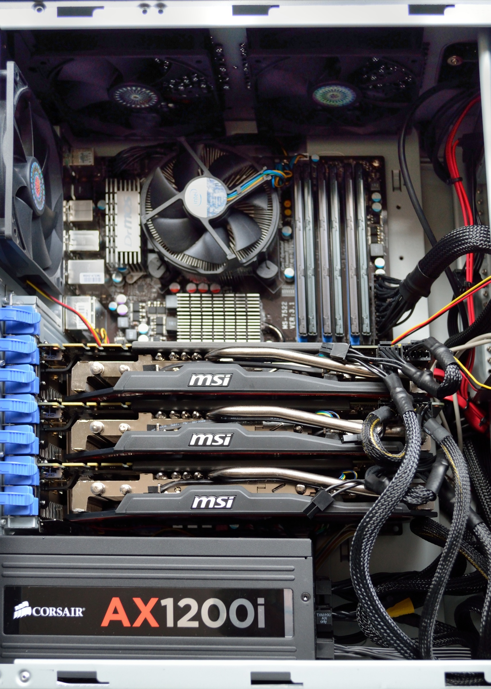

I got another question:
How can I check to be sure which GPU is the one I use for my monitor?
The confusing thing is that in Octane Render the GPU 1,2 and 3 are the reversed shown in the EVGA Precision X (I use for tweaking).
In the photo you can see the three GPU's and the top one I am using for my monitor.
The bottom one is near the Power unit, but my guess is that that is the one with the lowest temps, because the right fan on the GPU has the most space to breath.
Am I correct?

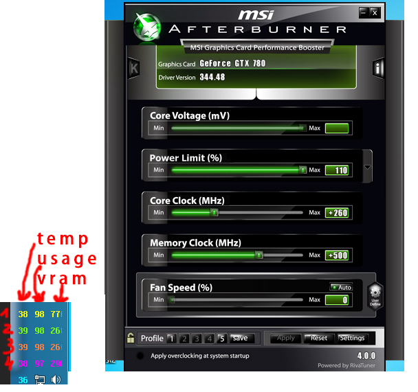

Rappet,
Use MSI afterburner - the numbering of gpus is exactly done in the same order as on your motherboard - the closest gpu to cpu is #1 and so on. And this should be hottest one on air (it absorbs heat from gpu #2). Look at the screenshot - I use msi monitoring at my task-bar - the first yellow row is #1,... (at idle and at load while rendering).
This is what I wrote earlier - an air-cooled system with 4 slots taken by gpus does not allow to use their full power. Once the temp limit is reached (i.e., 80C, you can set it in MSI afterburner) your cards will automatically reduce their core clock to preserve lower temps. And you can do nothing about it on air (or use raisers to separate them, but we are not talking about such coin-mining solutions).
Your cards - as you wrote - go at even 692 mhz. But on water they can easily hit 1200mhz at stock volts (1.2V I hope). So you see you loose almost 45% of their power on air. And temps are 80-95C, while on water 40-45C at low rpm fans, generating very little noise.
So install MSI afterburner and look at graphs depicting power, temps, core clock, memory clock, voltage and you see how your hottest gpus slow down while rendering.
You can do a test - take out of your case the middle card and leave only two that are two-slot distant from each other. You should see temp improvement.
PS. If you are not sure which gpu is which, set manually (afterburner) a fan speed at 100% and try to listen which card generates noise.

I did transfer end ended up with a 3x780ti that was getting to high temps, even within this new case Corsair Graphite 780T.
Because of the larger-then-normal PSU I only have one fan on the bottom, but that should not be the reason.
I suspect the MSI Twin Frozer Gaming GTX 780Ti is not that suitable for 3SLI without having slot space between the cards?
I have another case with 4x580 withous slot space and they work fine with the temps.
To check if it the card design difference I might swap 3x580 to the 780T case to see if the cooling of the case itself is OK.
For now I have removed the middle 780Ti card and ofcourse the temps are super low now.
