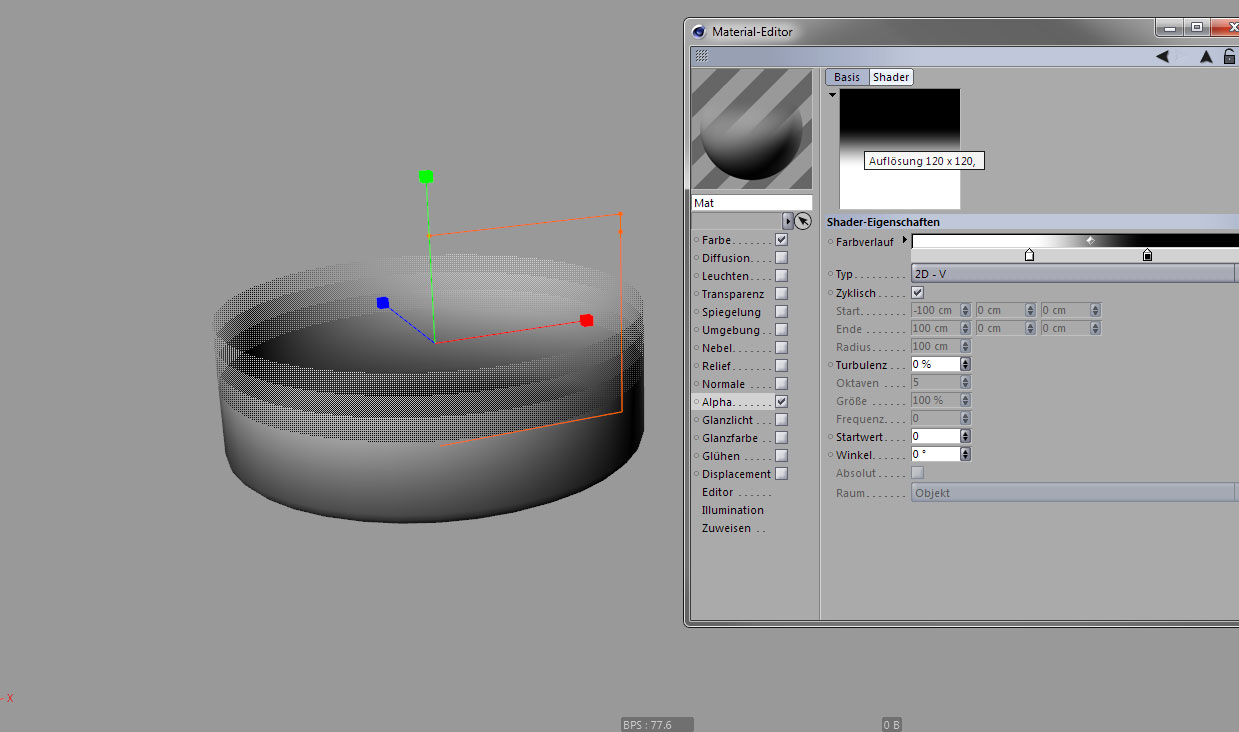

After asking on cgsociety forum, now I know how to do the 360 orbit in Cinema 4D.
Can you help to find a solution to make this work in Octane? I would like to avoid compositing in post if it is possible.
Basically I have a sort of deformed cylinder on which I attached the HDRI material. In this way I can move my camera without any problem, but now I'm not sure how to light my scenes in octane.
Outer view of cylinder
Inner view of cylinder
Which is the best route to light this thing properly and act like it is the environment? Should I use a texture emission? I tried something but it doesn't work I expect.
Any help is really appreciated, thank you.
