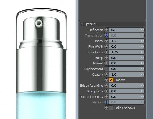

Thanks Paul. I did reduce the Ray Epsilon to 0.00001 but didn't see much of a difference. I then proceeded to change the Reflection setting of the clear plastic lid from 0.8 to 0.2. Also, not sure if this helped but changed the index from 1.4 to 1.2. Looks like one of those changes worked to get closer to what I was trying to achieve but have to do some more testing at different angles.

Hello rrbarb, this material is from the octane library. I loaded in one of the clear plastic materials and added above the MODO material, so it would take precedence.
As for the gamma, it didn't really help that much.
