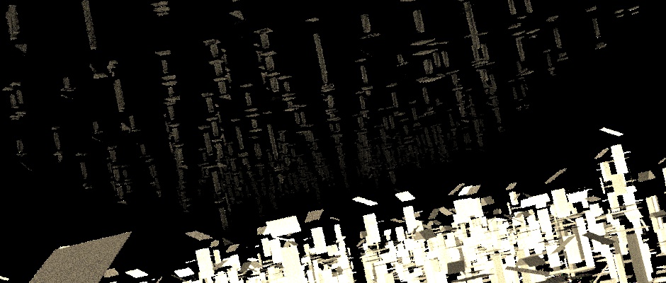

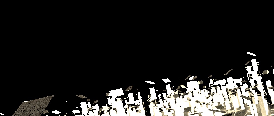

thanks for getting back to me. Attached are some images. It's a slightly complicated scene.

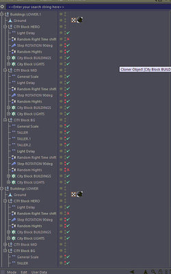

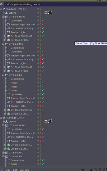

I'm going for this glowing-city look. The buildings are generated with simple geometry with a displacement material on them. The material is a specular material with absorption medium. Inside the buildings are the area lights. The buildings and the lights are in separate cloner objects, so I can use render instances on the geometry.

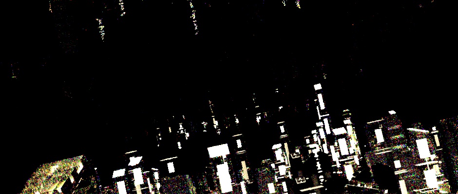

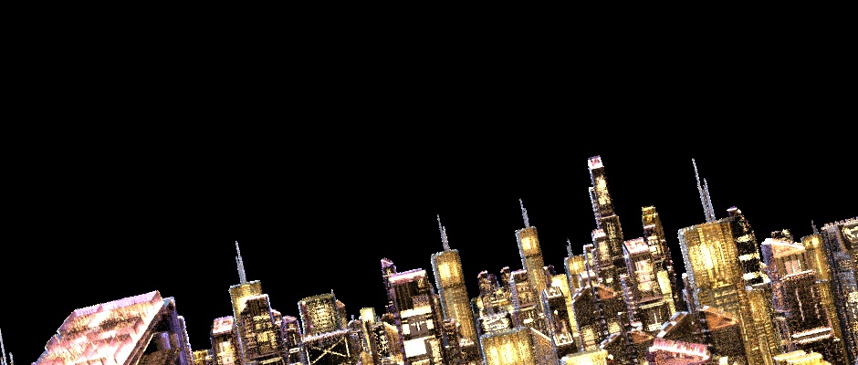

I want to have another instance of the buildings above, as if they are a ceiling. When I just have one row of buildings on the ground, it seems to work fine (see the second image attached) however if I duplicate it and put it above I get a very unexpected result (see first image)
I've tried everything I can think of! - Any idea what might be going on here?
Thank you!
Thank you!

doing a quick reply but still checking. I think there is a crash on your scene. You have about 8000 lights. It may be so much for interactivity.

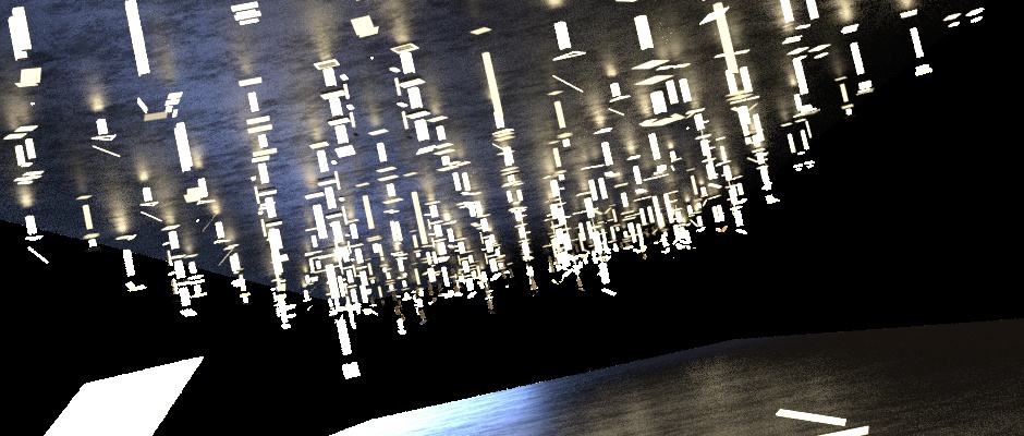

Just playing around, trying to troubleshoot the scene, it really seems like the lights on the floor has a drastic impact on the ceiling ones. I've attached some images demonstrating this. In order, the images show: 1: both lights on (the error. 2) top lights only. 3) bottom lights only.
Individually, the top and bottom light clones render fine. However when they are both turned on the top ones very much dimmer.
Please let me know if you have any idea what might be causing this! Really appreciate any help.
Win 8.1 / i7 4930k / 2 x GTX Titan / Cinema 4d
