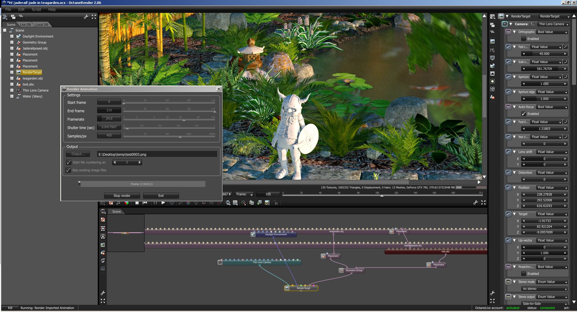

I bought the Alembic exporter for DAZ studio today
is there a helpful thread on how to use it?
I got the geometry scene in and can link it to a render target in the node editor with a camera and environment and found the animation export under scripts but it does not appear to be exporting any images even though it is rendering and moving in viewport.
Win 10 64-bit CPU Ryzen 3 3600g 32GB RAM graphics RTX2080Ti
wendyluvscatz
Posts: 88
Joined: Fri Sep 05, 2014 4:34 pm
I stand corrected
it is exporting images S_L_O_W_LY
how do I limit time rendering each frame?
cannot find setting
