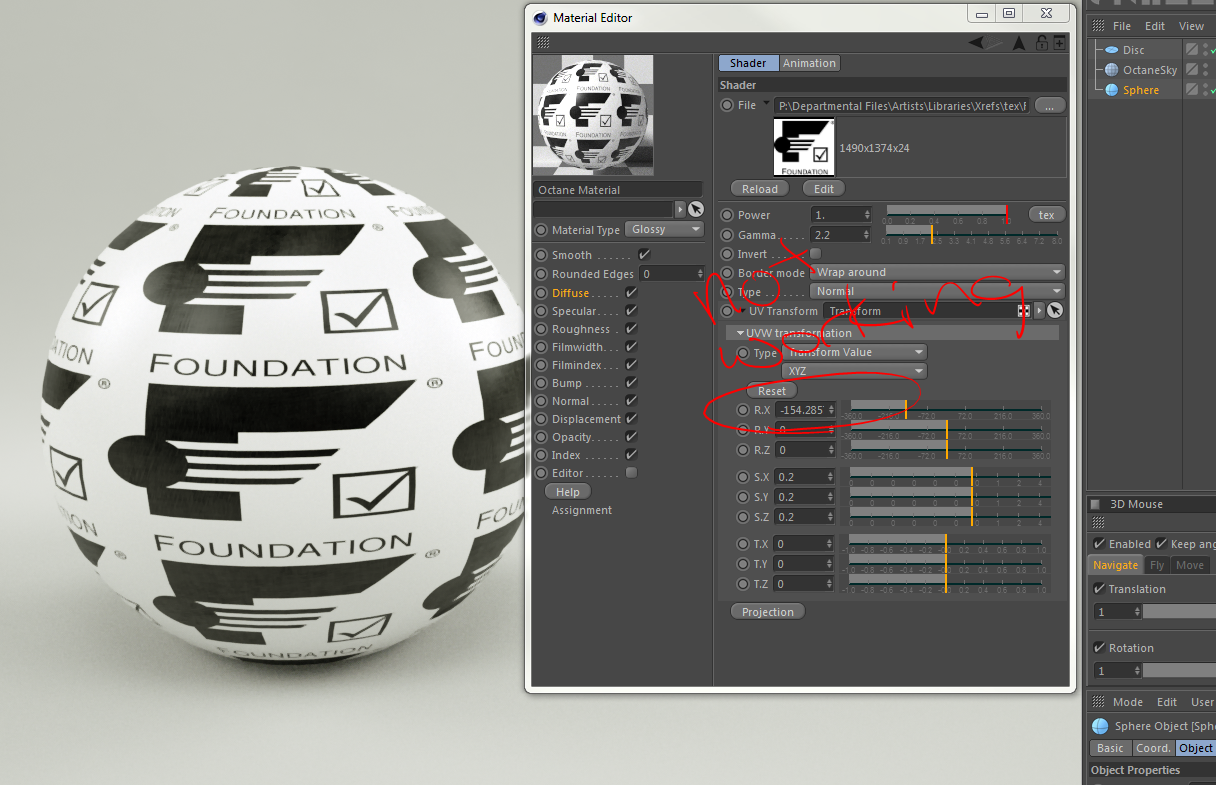

The rotation.x does not seem to be responding in any way, limiting the ability to control texture maps.

it's not POSITON, rotateX.
T.X, T.Y, T.Z = transform x,y,z

Yea, sorry, I meant rotation. Why wouldn't the rot.x work? Transform.x does what I need, but why would only the z work on rotation, and the z doesn't work on transform.

rodross wrote:Yea, sorry, I meant rotation. Why wouldn't the rot.x work? Transform.x does what I need, but why would the only the z work on rotation, and the z doesn't work on transform.
Because default projection is UV. You should try other projection types.

Ok, so basically use projection rotation.xyz instead, that seems to work on all axis, depending on projection. I still don't get why only one single axis would work in UV transform rotation, but ok, I just won't use it.
