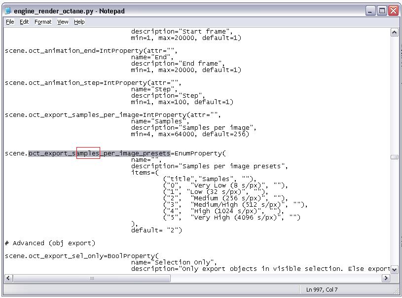

pixelrush
Posts: 1618
Joined: Mon Jan 11, 2010 7:11 pm
Location: Nelson, New Zealand
try opening the script in wordpad and find the text in my pic.
remove some letters from the word 'sample' to make the whole name less than 31 characters.
just leaving the 's' ought to work.
havent tried running this but saw the issue here when passing
HTH

steveps3
Posts: 1118
Joined: Sat Aug 21, 2010 4:07 pm
Location: England
As I suspected, you can't go changing variable names, willy nilly, the script complains like crazy now.

steveps3
Posts: 1118
Location: England
ah ok, I fixed the problem, the variable was used later in the script. I changed it there as well and i think we are in business.
