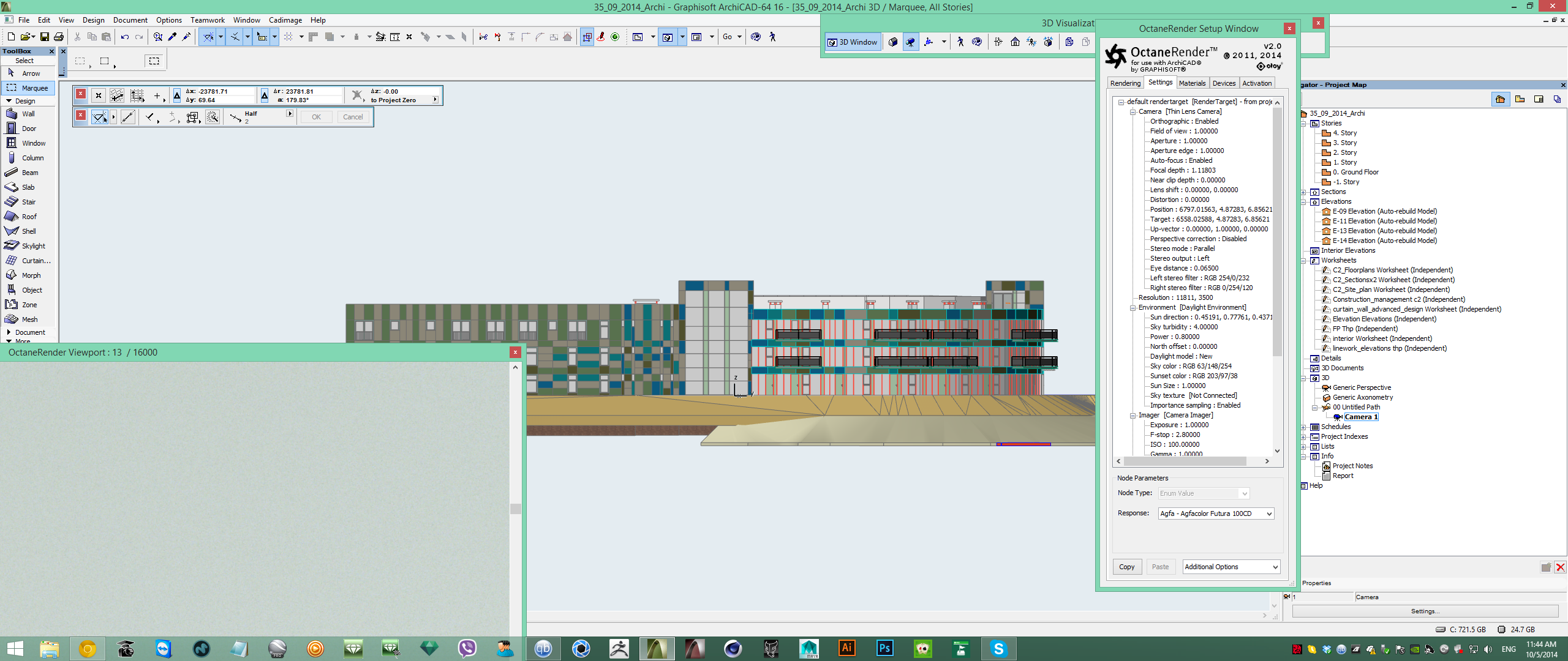

I dont get anything on the view-port of octane though . Took your advice on fov and made such a camera on perspective but when rendering I get nothing simple white canvas?

Your resolution is 11811x3500 and very high,
Therefor, in the preview you only see a little piece
You have to scroll in the the octane plugin viewport not only to see the 'emtpy' corner.
Try 1181x350 resolution to have a kind of preview to if it works.

The 8192 max has been increased. However 11811 is certainly too wide to visibly match the Octane camera to the ArchiCAD camera. I suggest unclicking Lock Resolution whilst you are getting the camera right - tick the "Orthographic" pin on the Octane camera, then move the fov or scale slider to get the correct size.
