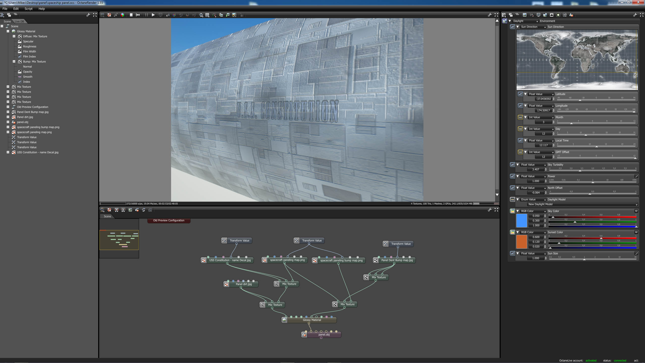

I then Imported the mesh into Octane and started layering up and positioning the various diffused and Bump Maps on the surface.
The result is attached.
One thing I found out is that you can Layer up Bump maps.I also Changed The Gamma settings on various layers to help with the strength of the bumps and the colors of the diffused maps to pass through the layers.
I've attached the .Orbx File if anyone want's to have a play !
