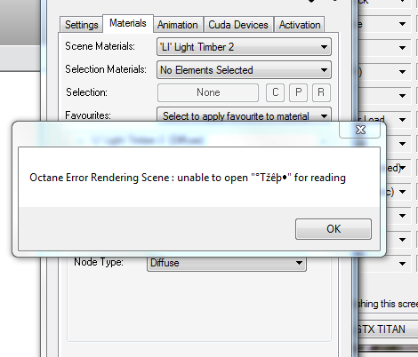

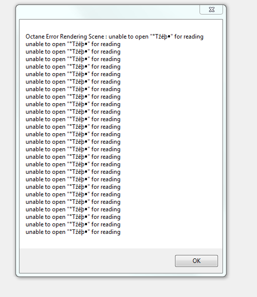

I downloaded version 02.10.0.11 today. I have a problem with materials when "loading from default". If I have a texture attached to a material I get the following message:
OctaneErrorRenderingScence:unable to open "T...(4 characters)"for reading.
I deleted 2.10 and went back to version 2.6.0.9 and everything works fine. I love the features and speed of 2.10.0.11- great job- just can't use it if I can't save textures on materials. Any idea of what might help?

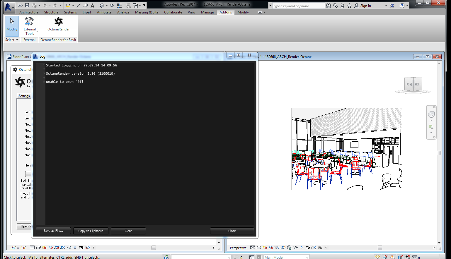

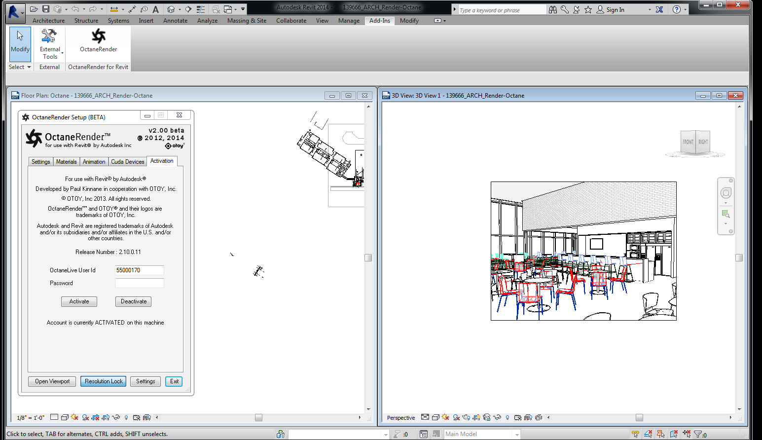

Thanks - it looks like an installation problem. Is it possible you were running Revit when you installed the plugin?
Can you pls post a screenshot of the Activation tab, and also post a copy of the Octane Log window (available from the Devices tab).
Paul

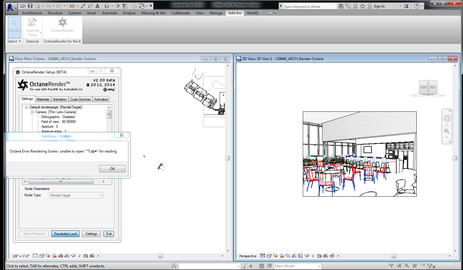

Paul,
I shut down the system, deleted the installation and downloads. I then re-downloaded the Revit 2.1 zip and installed. Still having the same issues. I've included the log file and activation tab. I've also included a screenshot of what happens when I try to import render target.
Again, all this is working in 2.06 (which is great by the way).
Ed
Ed

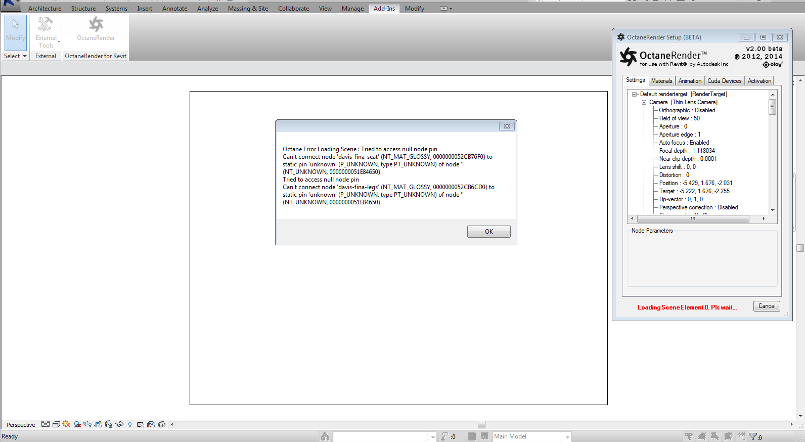

Sorry for the problems you are both experiencing. I haven't been able to re-produce the error, however I found a potential code issue, which I have corrected in the version below. Can you pls let me know if this fixes your issue? The installer is for Revit 2014.
http://render.otoy.com/customerdownload ... _Win64.exe
Paul
Paul
Would it be possible to send me a simple scene which reproduces this problem pls?
EDIT: I just installer from the installer I posted, and it is worked as intended. Would you also be able to provide the journal file from the crash, and let me know where it crashed pls.
Paul
