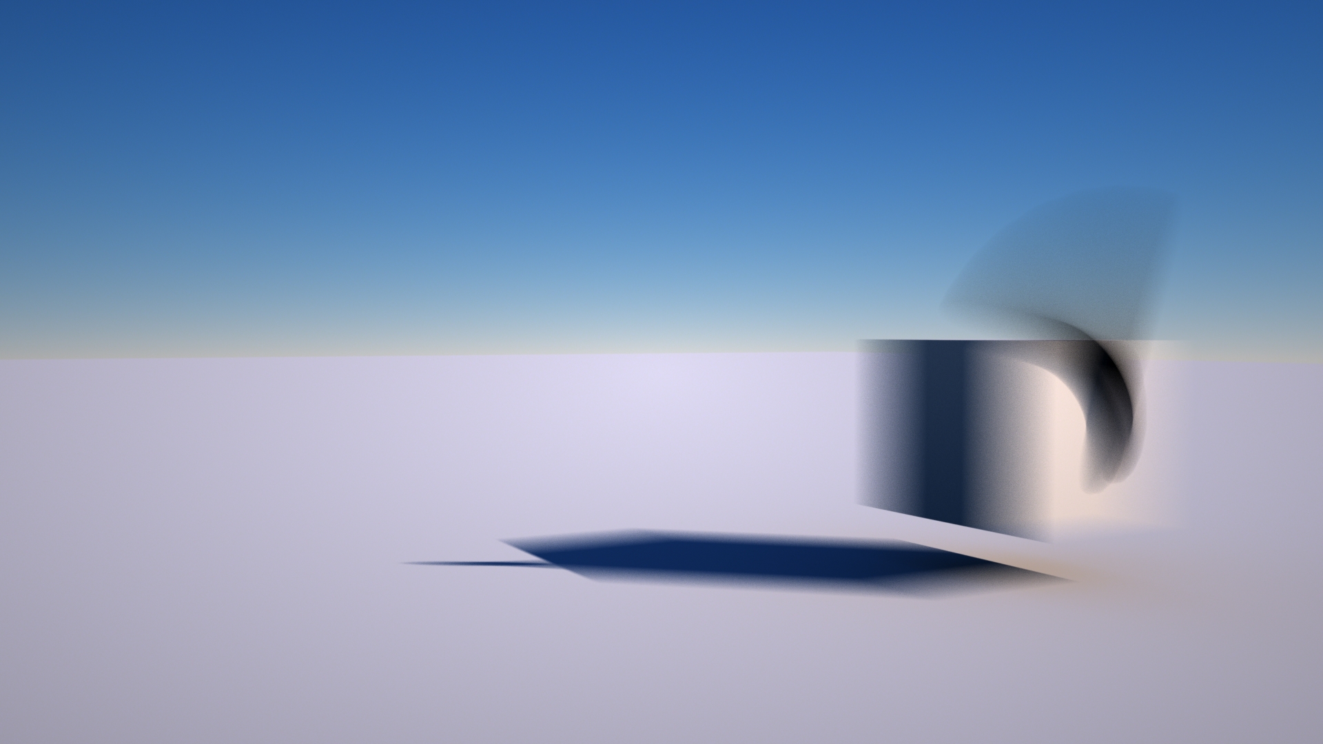

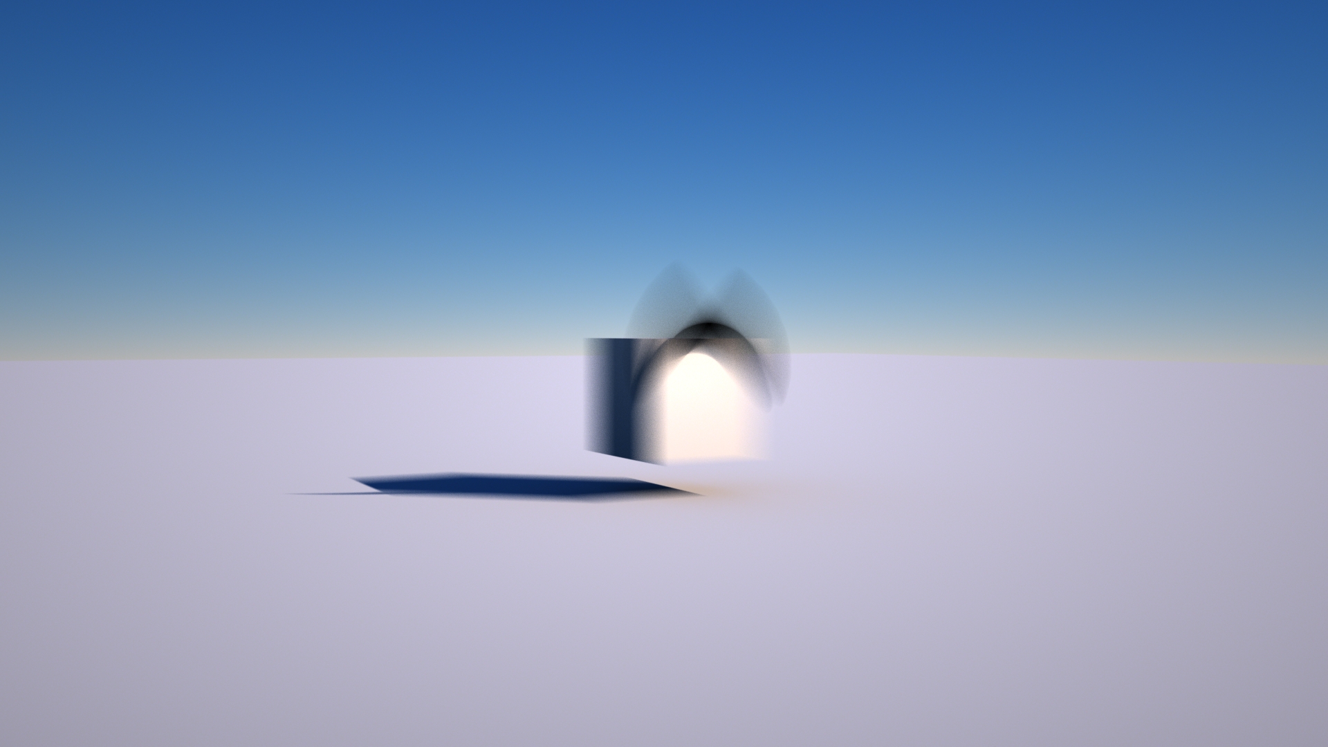

Here is a quick test that I ran to show some of the issues that I'm seeing.
Attached are a few stills and a link to a short animation. I'm using Octane 2.06 and 3ds Max plugin.
The scene is simple, it is a small rectangle that is rotated at a high velocity. and then linked to a box that is moving forward is space with high velocity. I have a more complicated scene for a project that I'm working on that actually shows much worse artifacts than this. But this will give you a good idea.
As for motion blur settings: Duration .5 (180 degree film standard).
Motion blur samples: 4 (I saw no difference when going to higher sample rate)
Movable proxy: Checked
vertex motion blur: UNchecked
object motion blur: Checked
https://www.youtube.com/watch?v=LnSuleJ7bMo
Can someone at Otoy please take a looks at this? or at least respond? I've posted about this in a couple other locations with no response.
Thanks!

bcravin wrote:Here is a quick test that I ran to show some of the issues that I'm seeing.
Thanks!
What is wrong with this video?

Please refer to the still frames from the video that help show the problem

bcravin wrote:Please refer to the still frames from the video that help show the problem
And what is the problem with them?

If that doesn't look wrong to you, I will post some stills from my current project to better illustrate the issue I'm having. But I keep running into the same issue where object with rotation that are moving in a straight line do not have proper motion blur. They have a weird curved motion blur.
You can see it in this picture I posted a few months back as well. The object is moving in a perfect straight line. no reason for the motion blur to look like that.

bcravin wrote:If that doesn't look wrong to you, I will post some stills from my current project to better illustrate the issue I'm having. But I keep running into the same issue where object with rotation that are moving in a straight line do not have proper motion blur. They have a weird curved motion blur.
http://render.otoy.com/forum/download/f ... &mode=view
Are you expecting straight lines in motion blur of rotating objects? LOL
