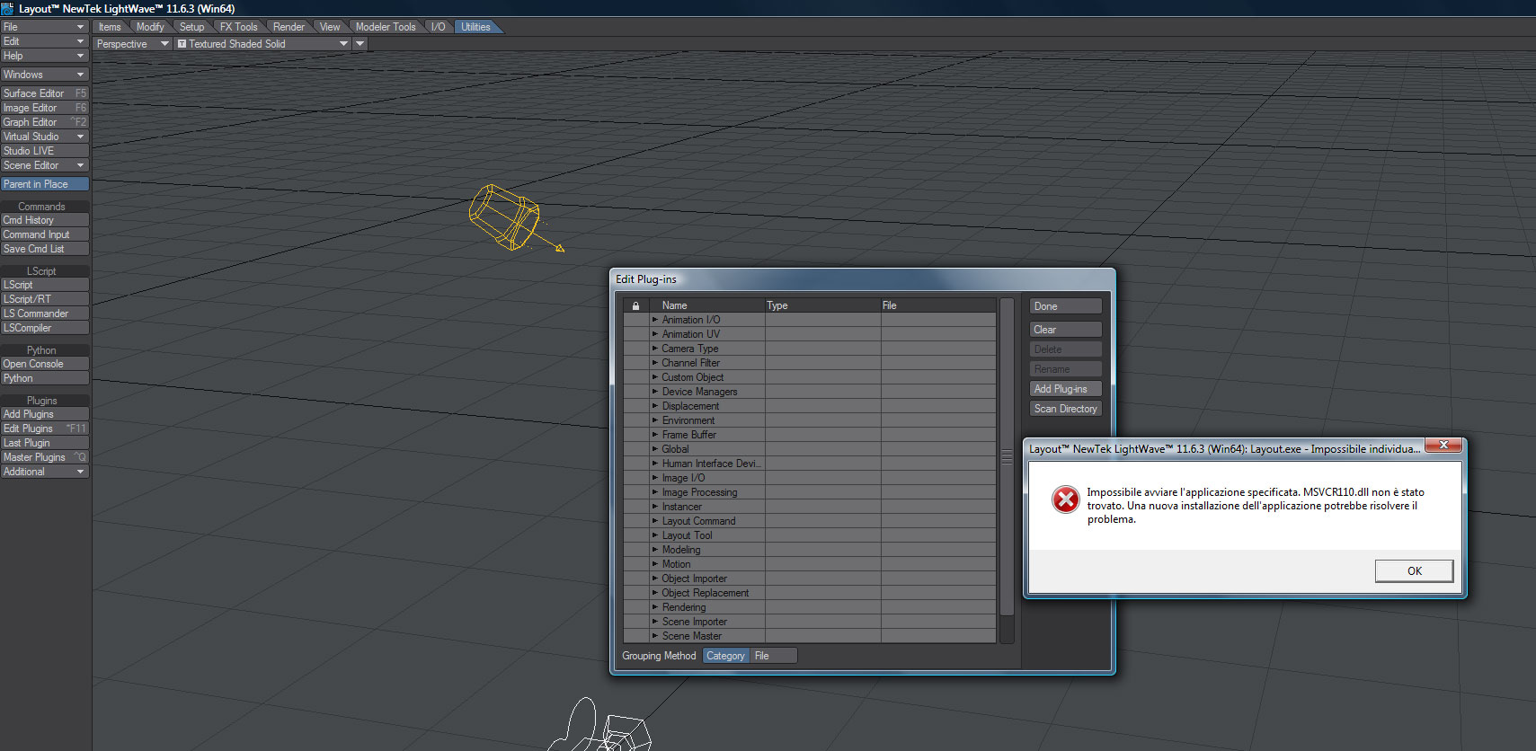

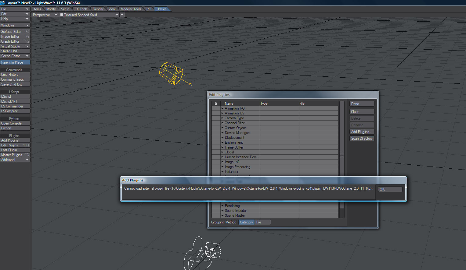

hello, sorry for my bad English, I installed lightwave 11.6.3 and tried to install the latest version of the plugin, but I got the following errors before I look for a dll and then does not find the plugin, not in earlier versions I never had this problem, I state that I had installed the 1.5 and I have never installed the previous version of 2.xx plug in, can you tell me what can I do?

You need to install the Visual C++ 2012 SP4 for Windows x64 redistributable package in your system.
Please download the "vcredist_x64.exe" file from this link and install it:
http://www.microsoft.com/en-US/download ... x?id=30679
-Juanjo

Sorry if you answered before, but thank you very much you have been extremely kind to solve my problem, thanks a lot again juanjgon :D
