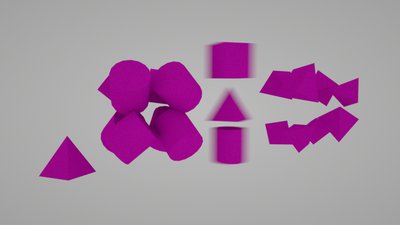

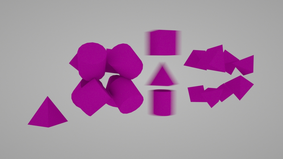

Unparented Camera
Unparented Camera
Here you could see some instances and some regular objects which are all parented to a Null which is moving from right to left. The camera has a locked position. The three objects in the middle have correct motion blur applied, but the instances have no motion blur at all.

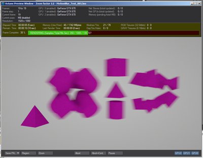

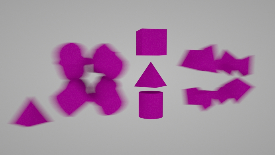

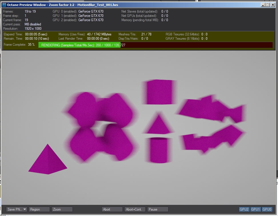

Parented Camera
Parented Camera
Now I have parented the camera to the moving Null. In relation to the objects the camera should have a locked position, which is true for the three objects in the middle, but not for the instances, which are now blured. Bad behavior, bad.

You can't set the motion blur length above 100% ... it is not supported by the plugin, and adds wrong motion blur data to the instances. Please, set the length to 100% or less to fix your issues.
Also rememeber that the instances and deformations motion blur is only available in the final F9/F10 rendering. Out of the rendering stage LightWave can't send to the external render plugins the instances MB information. If you render your scene with F9 all works fine.
