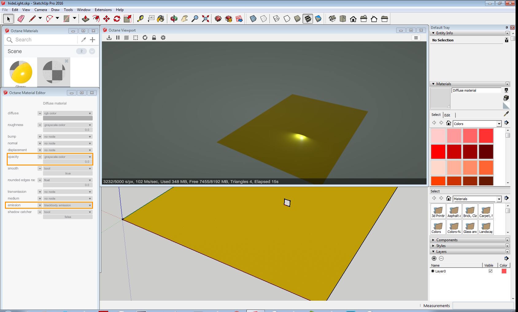

Hi Jorgensen,
Sure, just create Diffuse material, set emission and then set opacity to 0. Object will be invisible but preserve emission.
Fuzzy

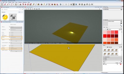

Excuse me, do we need to set the opacity to 0 of the material attached or the object?
Jorgensen
Posts: 872
Joined: Sun Jun 30, 2013 10:53 am
i'm trying to redo this - create an object add a diffuse material, add emission material with blackbody emission, but when i change the opacity both the object and light disappears.
what am i'm doing wrong :-(
thanks
jorgensen
HOME octane standalone v3.07 | octane plugin for sketchup 3.07.0.14 | sketchup pro 2017 17.2.2555 64 bit | windows 10 pro 10.015063 build 15063 | i7-6700k @4.0 GHz | 32gb ram | 2x gtx 1070 | nvidia driver 382.33
Jorgensen
Posts: 872
hi beppe
your right - now i works here to - don't know what i did wrong.
thanks
jorgensen
