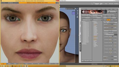

Thank you for making this preview version available, seeing several new functions in the 1.5 version i'm really happy with.
Especially the import/export options, makes me very happy ! Did a quick experiment with a clean V4 and importing a Octane Project file (V4 data/materials. Exported from the carrara plugin) and despite this is a work in progress/ preview build it actually worked very nice..did not expect it to work
I did a clean install of the DS public build and installed the 1.5 version there. This worked fine. So i now have the DS public build for the weekly OcDS build and the DS version form the general release for the 1.2 version.
Definitly will be following the weekly builds
