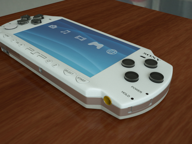

bepeg4d is right, I used a similar technique on the Psp screen
Psp Screen
Psp Screen
