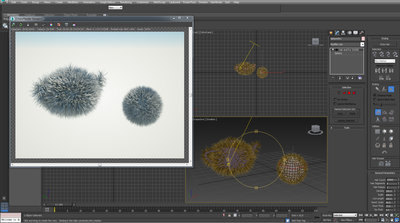

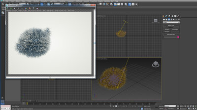

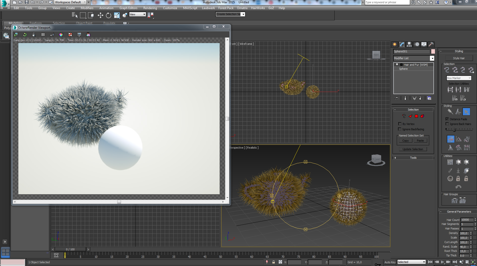

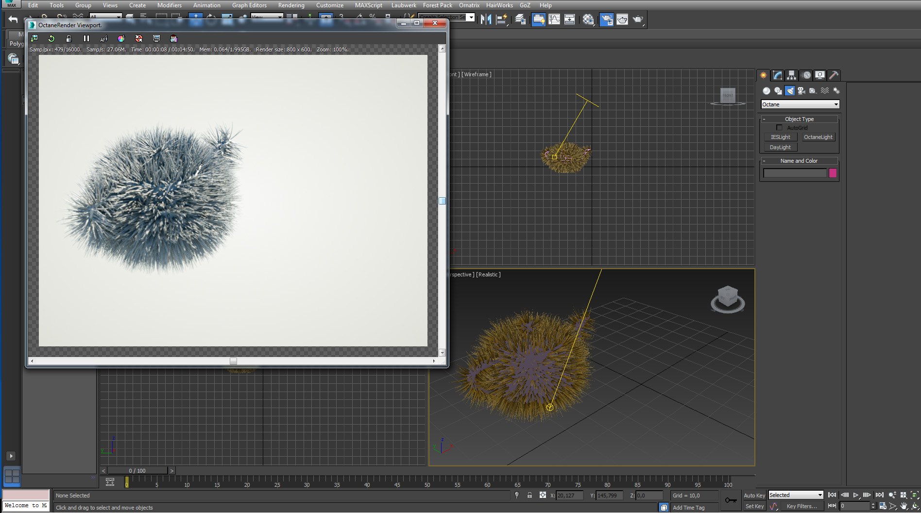

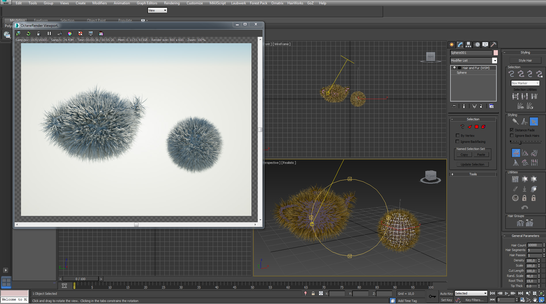

I don't know if it is a bug, but when i add an object with hair and fur modifier in my scene, update render geometry button doesn't work, i have to close and then re-open octane viewport to get visible my new object with hair and fur.

These are the same steps i follow, but if i add a new object like a sphere with hair and fur applied when octane viewport is already open, update geometry doesn't work.
The sphere appears without hair and fur, then i have to close and open again octane viewport to see hair and fur applied to the sphere.
