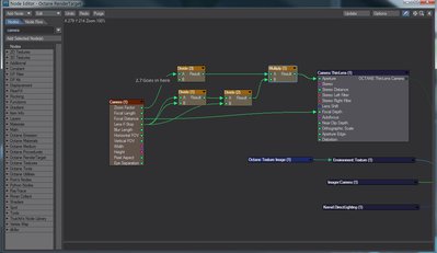

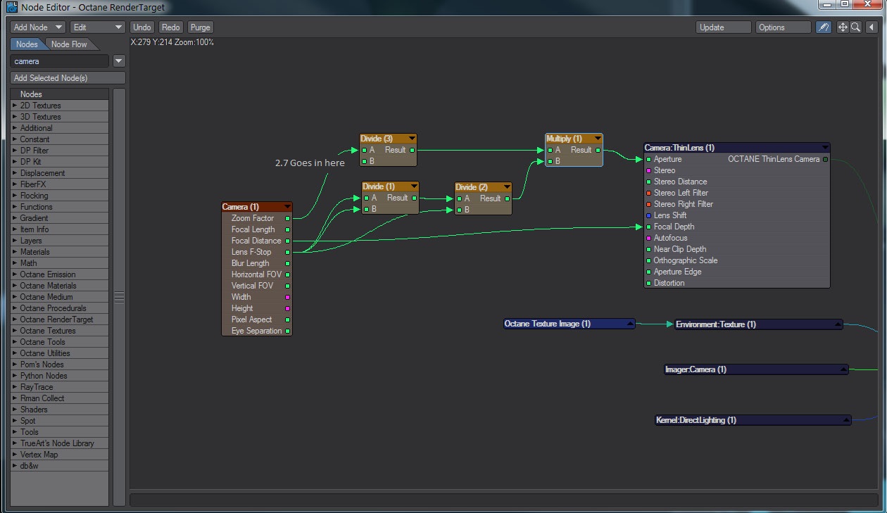

Someone posted this graphic for using the lw camera's dof settings to control the Octane camera's dof.
I have found it indispensable and keeps it lw-ish.

UnCommonGrafx wrote:Someone posted this graphic for using the lw camera's dof settings to control the Octane camera's dof.
That's neat. You could just add the null for setting focal distance thing and it would be superb.
